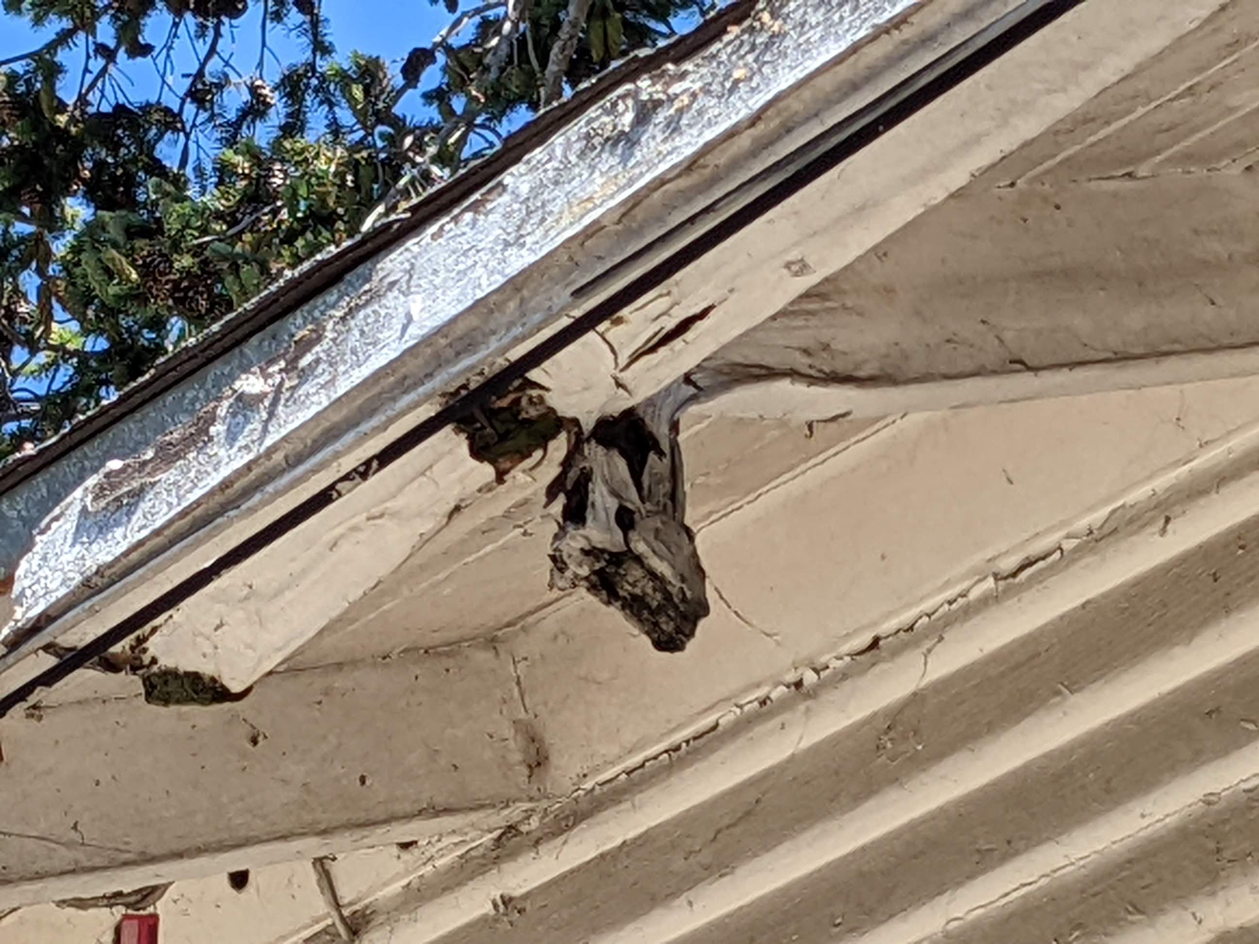

Droopy dog eared rafter.

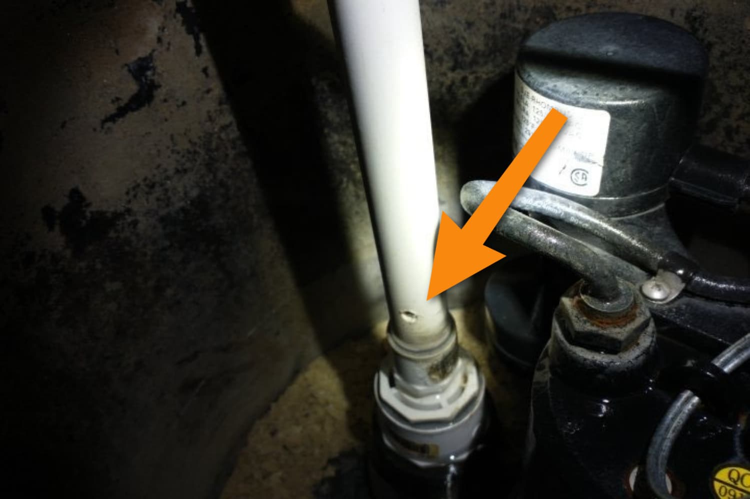

Kinda big for a needed weep hole

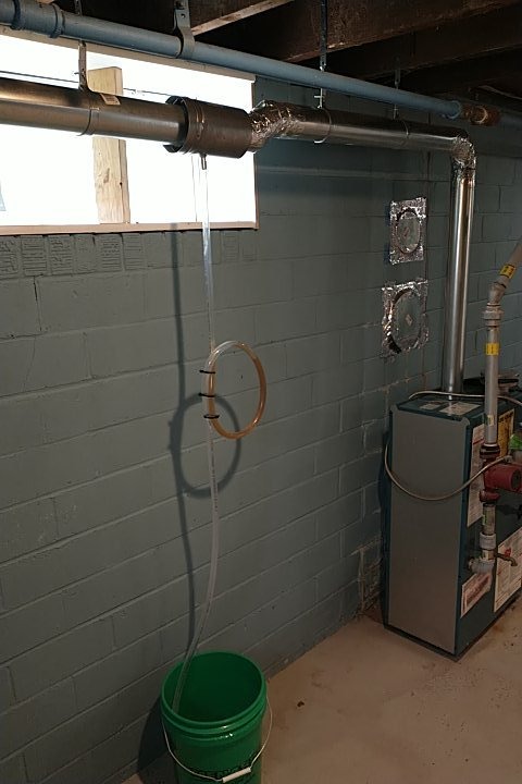

The correct stainless steel gasketed vent pipe is not that crazy expensive where it would be worth doing all this work to try and use b-vent, lol. High efficiency mechanical/power vented gas boiler. The run could have been made way shorter as well.
Tell us a bit more about what they tried to do…
Basically they used b vent and taped all the seams instead of using the gasketed stainless steel vent components required by the manufacturer. They for some reason ran the vent clear to the front wall of the home as well, when they could have easily went out the same side the furnace is on, using a much shorter run. That would have made the cost of using the correct vent fairly close to the cost of using 30 feet of b-vent, lol.
I don’t know if you’ll even find a manufacture that says to install a weep hole anymore. All the pumps have a built-in vent nowadays.
