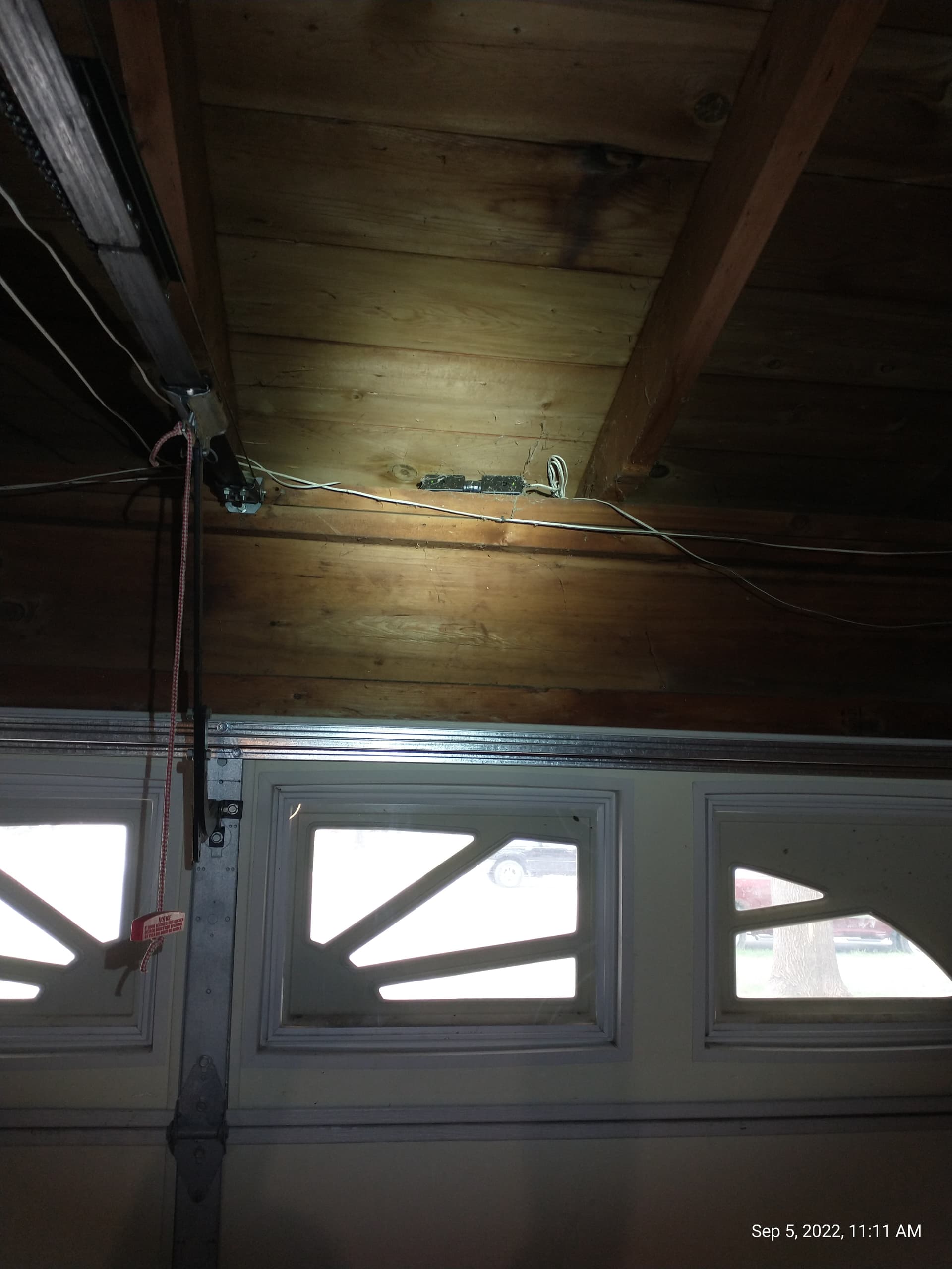

On today’s episode of “Where are the garage door safety eyes?”

They don’t get hit and damaged up there. LOL

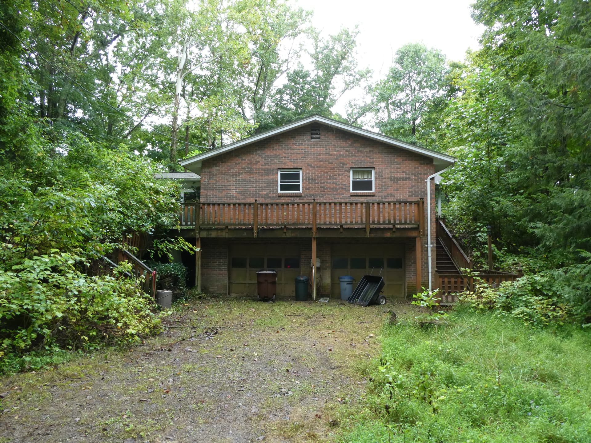

Vacant for over 3 years, at least they mowed the driveway.

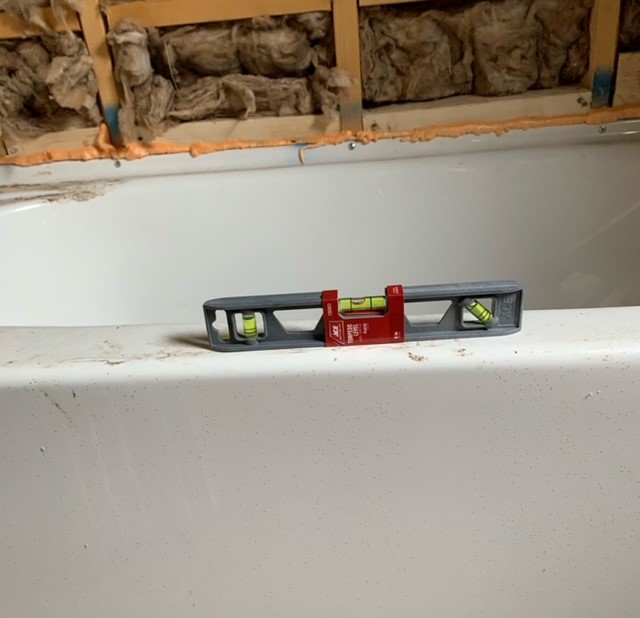

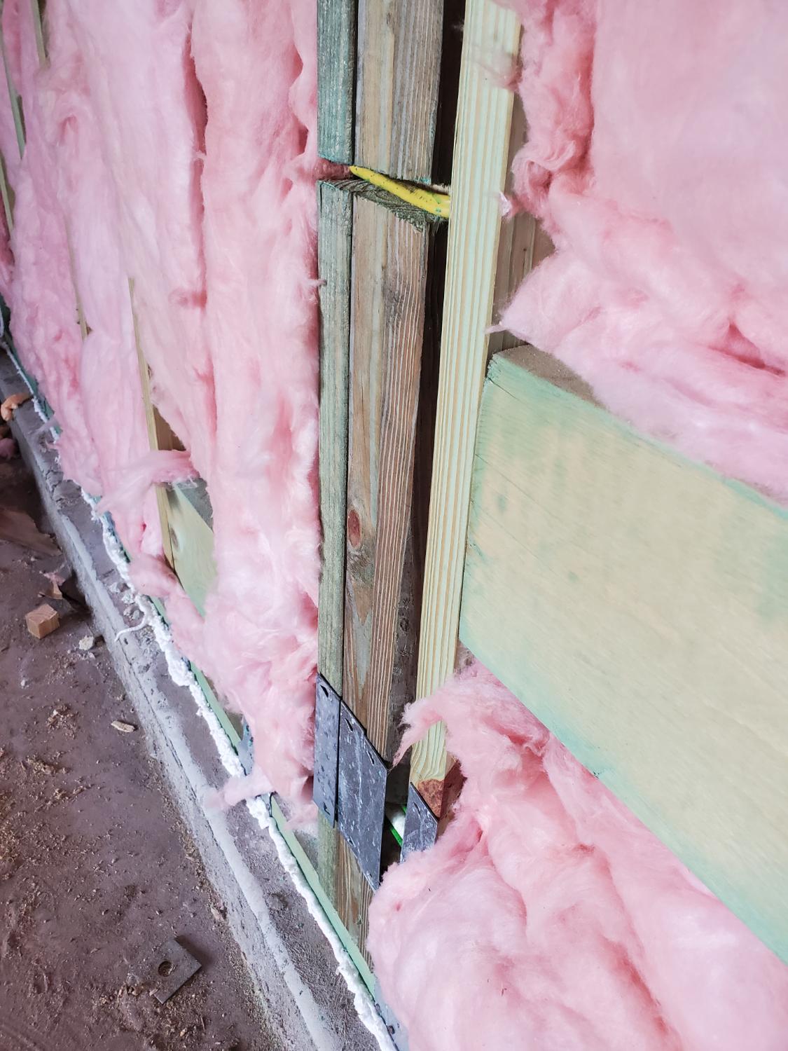

I did a pre-drywall inspection last week, called out a tub that was out of level by 5/8" from one end to the other.
Builder sent this photo to the buyer and said that the tub was deemed “level”
Even a stupid torpedo level is off!

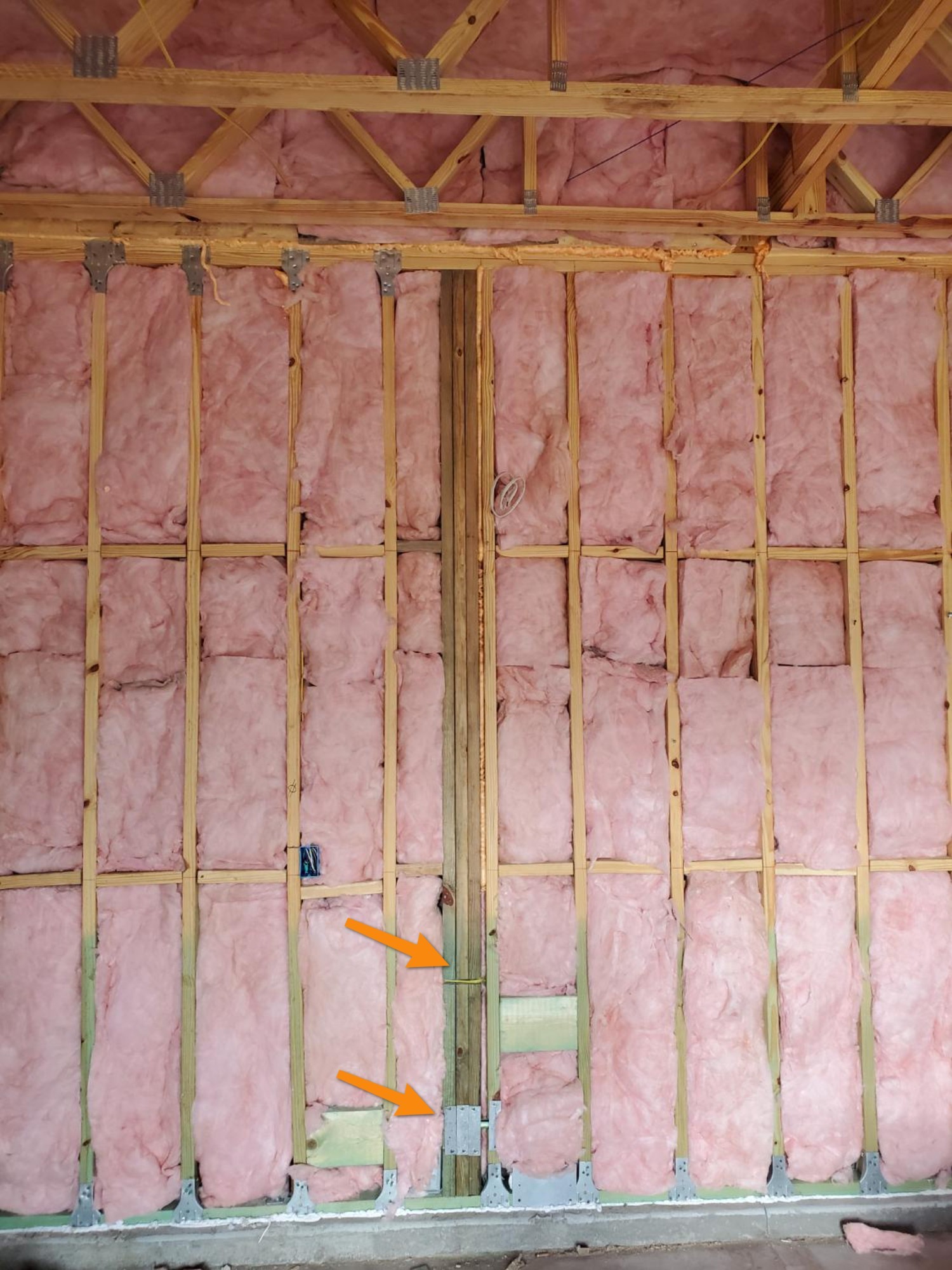

They also said that this load bearing stud pack was found structurally secure. (it continues up through the second floor as well)
They have the studs notched out 50%, (max allowed is 25%). Probably wont do anything about it. But honestly, it probably isnt a huge deal considering the rest of that wall…

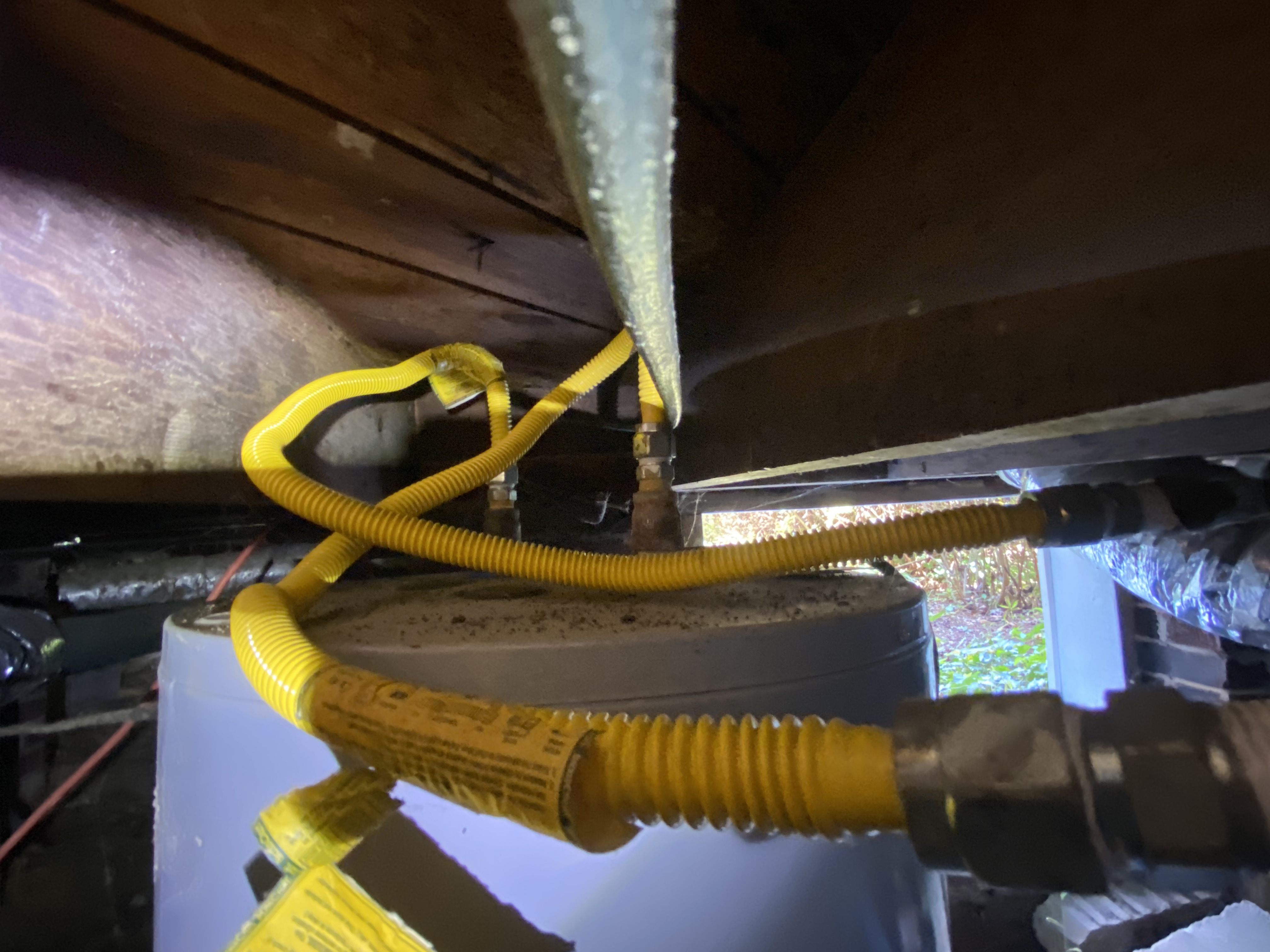

Anyone familiar with these types of plumbing materials??
mwilles
(Martin Willes)
September 7, 2022, 7:44pm
805
I like those appliance fuel connectors being used as water piping material
bcawhern1
(Brian Cawhern, CMI)
September 7, 2022, 7:48pm
806
Yep, and let’s be sure to put as much strain on the electrical wire as possible.
bhubbard3
(Brian Hubbard)
September 7, 2022, 8:10pm
807
Haha I saw it and did a double take and had to check the label just to make sure I wasn’t going crazy…

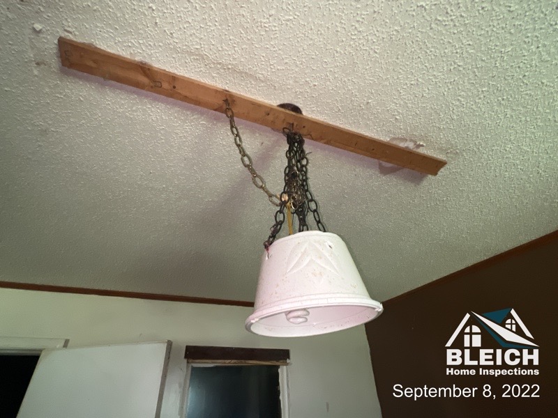

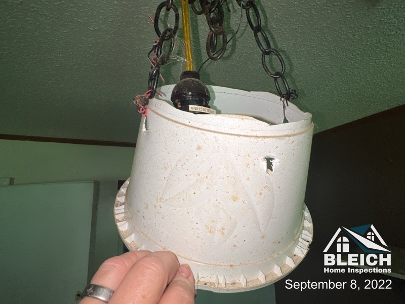

Homemade lamp shade made from inverted plastic pot.
bcawhern1
September 8, 2022, 4:36pm
809
Looks like a Pinterest project gone bad!

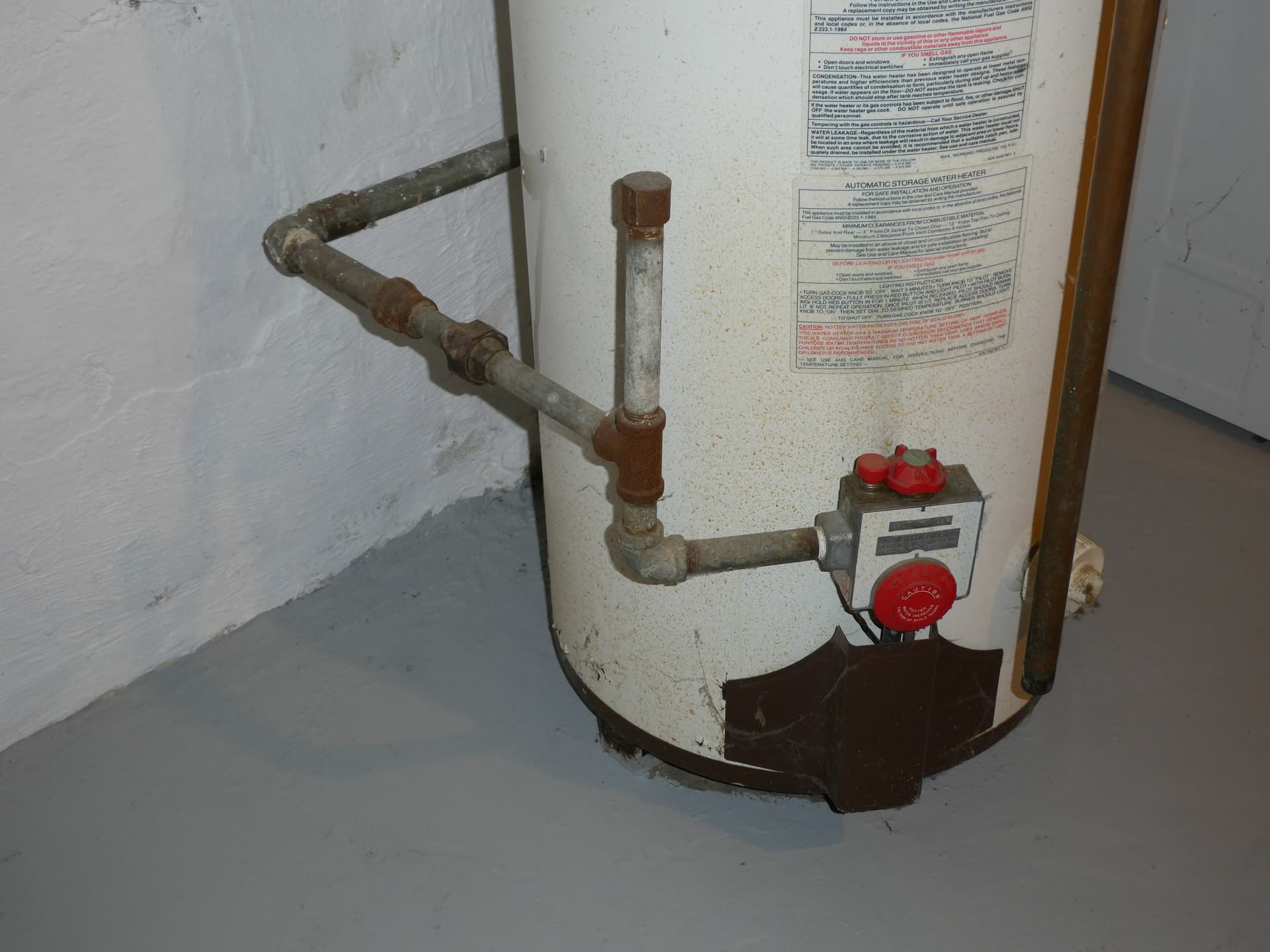

That would be a dryer vent into a natural draft flue. Not my picture (fortunately?)
