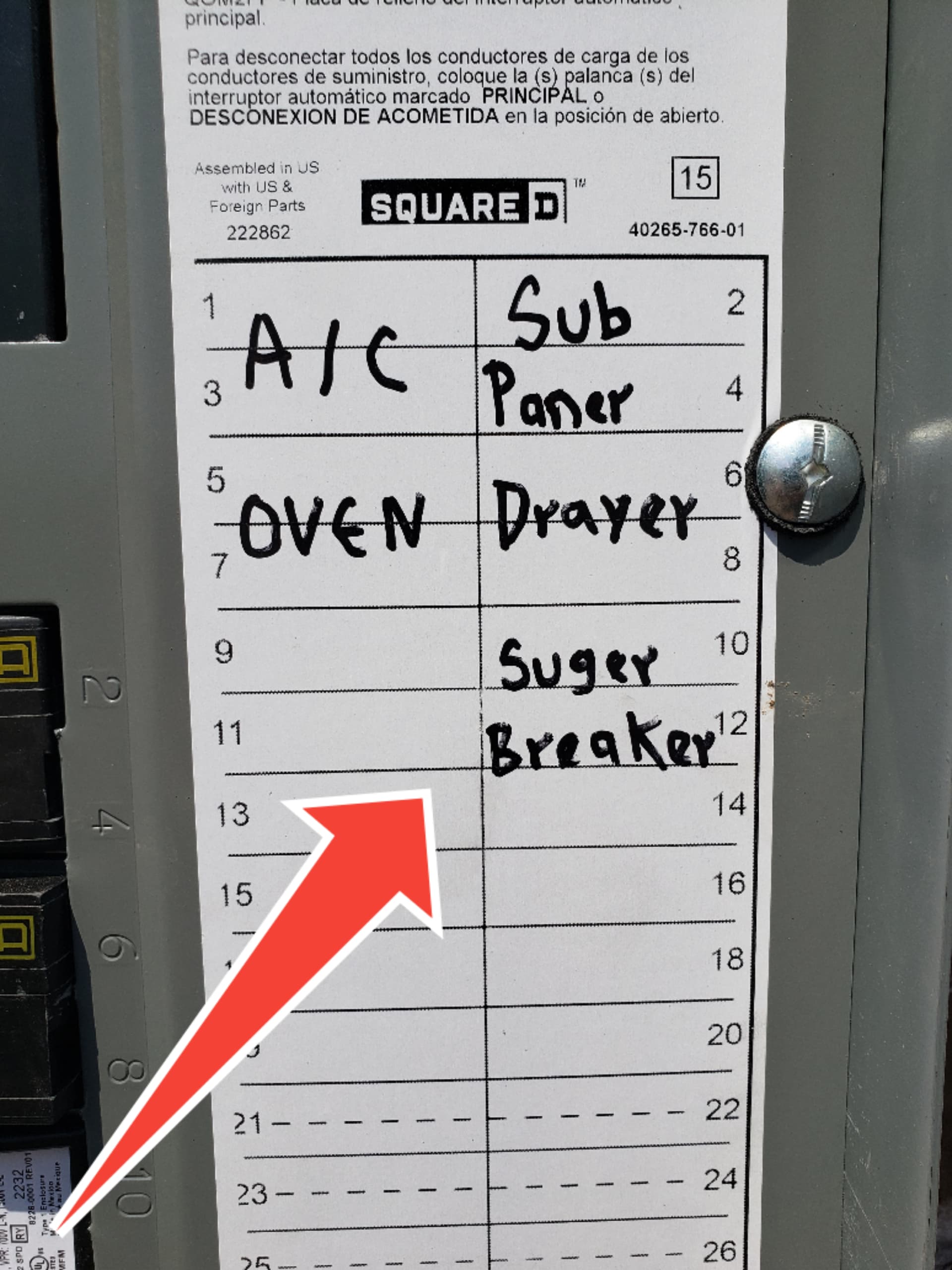

Just wondering if any of you know of any recalls on the new Sugar Breakers?
Sub paner
Drayer
Suger Breaker
Most of the new construction around here also have a circuit labeled “Smockies”; spanish for smoke alarms.
