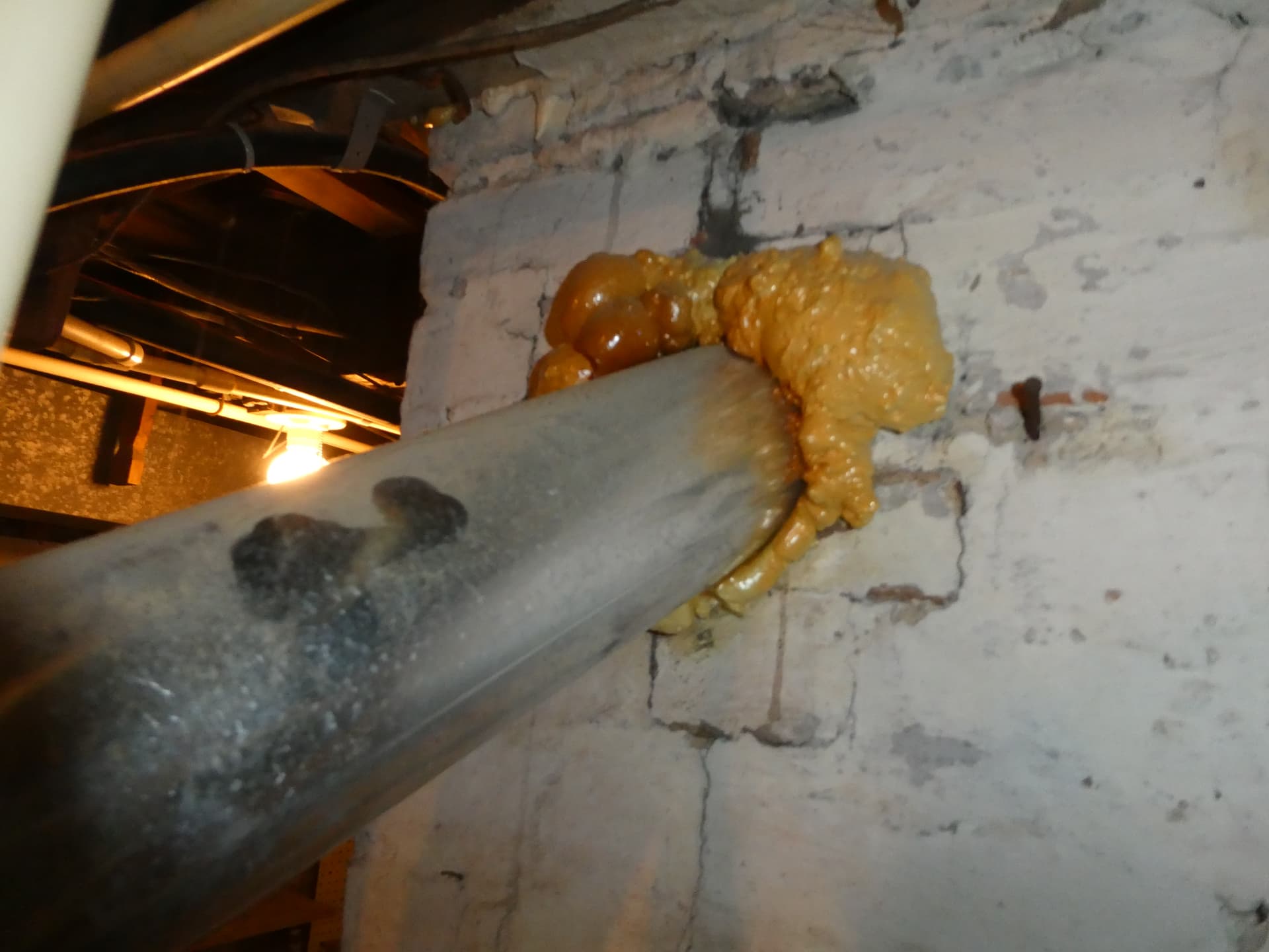

Too Much Spray Foam Insulation To Fill A Hole On The Other Side Of This Wall.
And yet another use for expanding foam insulation, around the WH vent at the chimney to keep the fumes out.
Especially good for single wall pipe, as it will help set the foam.
I like 'em nicely browned, too, Kevin… :roll_eyes:
