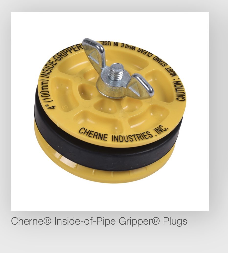

Does anyone know what this yellow plug is and why it would be inside the plumbing vent stack ?

Test plug,

Why is it in there and what is it testing?
should it be removed ? YES I looked it up. Thanks guys, I learned something new today
Was the pipe still in use? If so, shouldn’t be blocked. Probably left behind after pressure test.
Cherne mechanical test plug.

Yeah, I’ve found many over the years.
The plumber leaves the test plug in until he gets paid when the homeowner flushes the toilet and the water does not drain he calls the plumber to fix it, the plumber receives his payment, and then he removes the plug, problem fixed. :stuck_out_tongue:
Occasionally I will see them when they have installed a future vent for a basement rough in.
