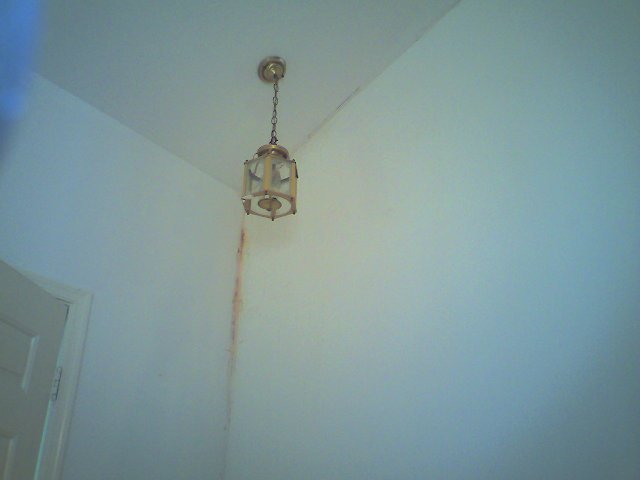

Yeterday afternoon’s inspection. Moisture found on wall/ceiling of foyer (roof leak). Someone tried to cover it up with some paint. Notice the paint rolls in the thermal image.

Just a thought, Keith;
Could it bet that the wall was painted within the last 24 hours?
I, regularly, see condos that are near completion and have similar thermal signatures. When I come back (a couple of days later and after a rain) the anomoly is gone.
Remember, drying paint is cooler.
If this is not the case, please disregard this.
BTW: Permission to use this image?
Great pic. any signs of leak on the exterior?
Hey Will,
I guess seeing just the thermal image you could possible come to this conclusion, but this was very obvious and moisture damage was evident. In addition, my moisture meter pegged through the roof.
This leak migrated down the wall all the way into the basement. I’ve attached the control image (from my IR camera) and a digital image.

Fine. No slam intended, just doing due dilegence.
I got messed up, early on, with new condos, where they just painted. So I tend to be cautious.
