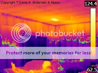

So, how do you get cold air off the floor in the winter time? If cold air can get sucked up into a ceiling register, the air speed is so high you’ll freeze at 102F.
Turn on the thermal camera in the winter and you’ll see what I’m taking about.

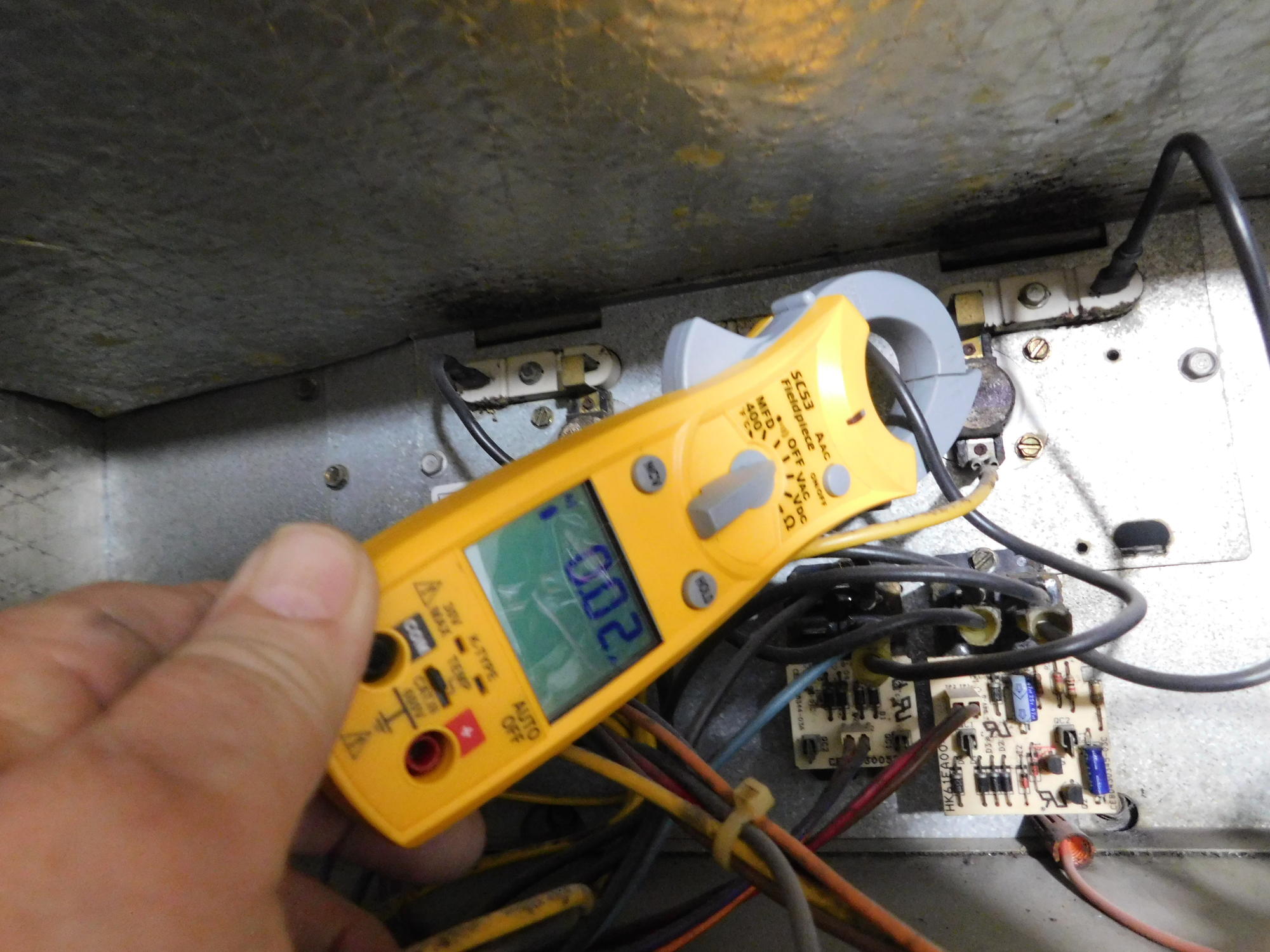

The electrical furnace had 3 5KW heat strips and the middle strip was not operating as indicated with the amp meter. I am attaching a pic of the heating elements.

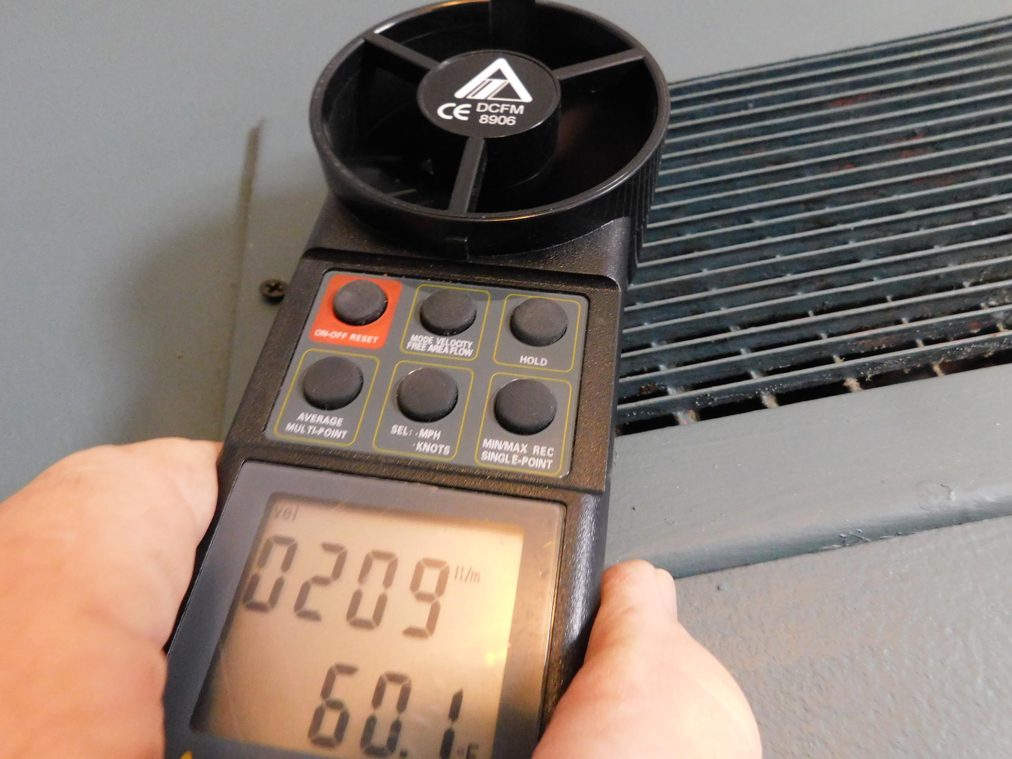

Nice well kept 1996 custom built home today. **2650 SQ FT **one story on a slab foundation. Two A/C units split systems. The west side had a 1.5 ton A/C serving the master bedroom, two small bedrooms and two bathrooms. The remaining area was served by a 2.5 ton split system A/C. Both A/C units had been updated once since 1996. The west furnace was a down flow gas fired forced air updated in 2016 with updated A-coil located in a exterior closet. The east furnace down flow gas fired forced air located in the garage closet and was a 1996 model with an updated A-coil. The supply air duct beneath the slab foundation was a combination of metal and plastic PVC schedule 20 and had adequate CFM air flow at all floor registers as measured at the floor registers.
Both systems had one return air grill each mounted in the ceiling of their respective locations east and west. The return air duct located in the attic was flex duct for both systems.
