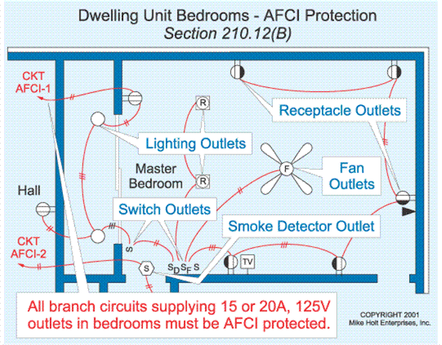

The smoke detectors can be on a separate AFCI circuit.
See pic:

But the way I teach it in my local school and to local AHJ’s that attend is that the SMOKE as Greg stated is an outlet…and must me on AFCI…regardless of the “RANDOM” what IF’s…
Larry…might be additionally helpful to your image to post the actual verbage MR. Holt uses to explain this as well…so I posted it below.
Update 2002 NEC -
The word “receptacle” was deleted and the words “listed device that protects the entire branch circuit” were added. This subsection now reads:(A) AFCI Definition. An AFCI protection device provides protection from an arcing fault by recognizing the characteristics unique to an arcing fault and by functioning to de-energize the circuit when an arc fault is detected.
(B) Dwelling Unit Bedrooms. All branch circuits supplying 15 or 20A, single-phase, 125V outlets installed in dwelling unit bedrooms must be AFCI protected by a listed device that protects the entire branch circuit. Figure 210–4
Author’s Comment: This applies to all outlets, including smoke detectors.
