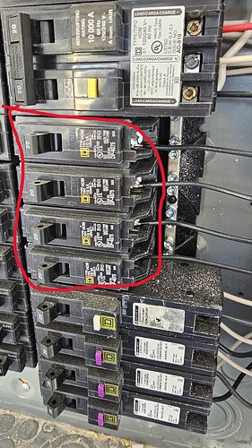

Just did a new-construciton home, permitted in 2025. The city says they have adopted the newest version of the Florida Building Code, which follows the NEC.
The builder has GFCI outlets installed in kitchen and baths, but I thought they had to have AFCI in all 20 amp circuits too? I don’t do many new homes, but In those I do, I usually find dual AFCI/GFCI breakers for the kitchen.
They DID put in a dual GFCI/AFCI breaker for the Refrigerator and microwave.

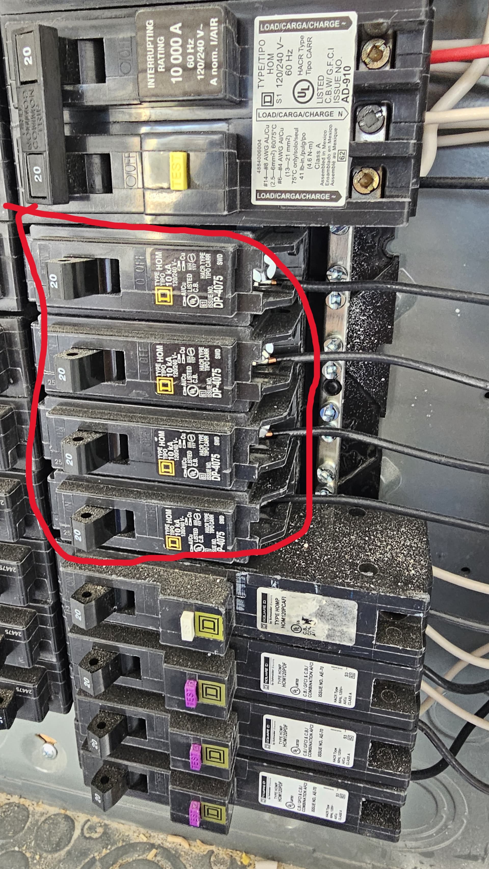

The 20 amp circuits labelled “Kitchen Outlets” are not AFCI.
2 circuits circled are Kitchen, others are Garage, and Bath GFCI’s.
I don’t want to cite building code, but this is not right…right?
The refrigerator should be a dedicated circuit and I wouldn’t want a GFCI on it, regardless of what AHJ might say.

The kitchen circuits should be AFCI protected. It’s possible (but very unlikely in this area) that they are protected somewhere other than the panel. Permitted in 2025 would be under the 2023 FBC and the 2020 NEC.

Yes, I know I’m not a code inspector-but those codes are supposed to improve the safety of the home, and I will call it out if it could affect the safety. And with a newly-built home, I can at least be reasonably sure of applicable codes-not like something built 50 years ago.
I agree about the GFCI on the refrigerator - I have seen a few of these dual GFCI/AFCI breakers trip with the refrigerator… not happy home owners!
As you’ve stated AFCI protection is required for all outlets in a kitchen under the 2020 NEC.
210.12(A) Dwelling Units.
All 120-volt, single-phase, 15- and 20-ampere branch circuits supplying outlets or devices installed in dwelling unit kitchens, family rooms, dining rooms, living rooms, parlors, libraries, dens, bedrooms, sunrooms, recreation rooms, closets, hallways, laundry areas, or similar rooms or areas shall be protected by any of the means described in 210.12(A)(1) through (6):

Thanks for the advise - I did reach out to the AHJ - I am meeting them back at the home later today to verify the installation. He confirmed that they do follow the NEC and these SHOULD have both AFCI and GFCI protection.
Yes, SHOULD be, but not required.
Correct. And as refrigerator technology advances it will be even less necessary to use an individual branch circuit.
