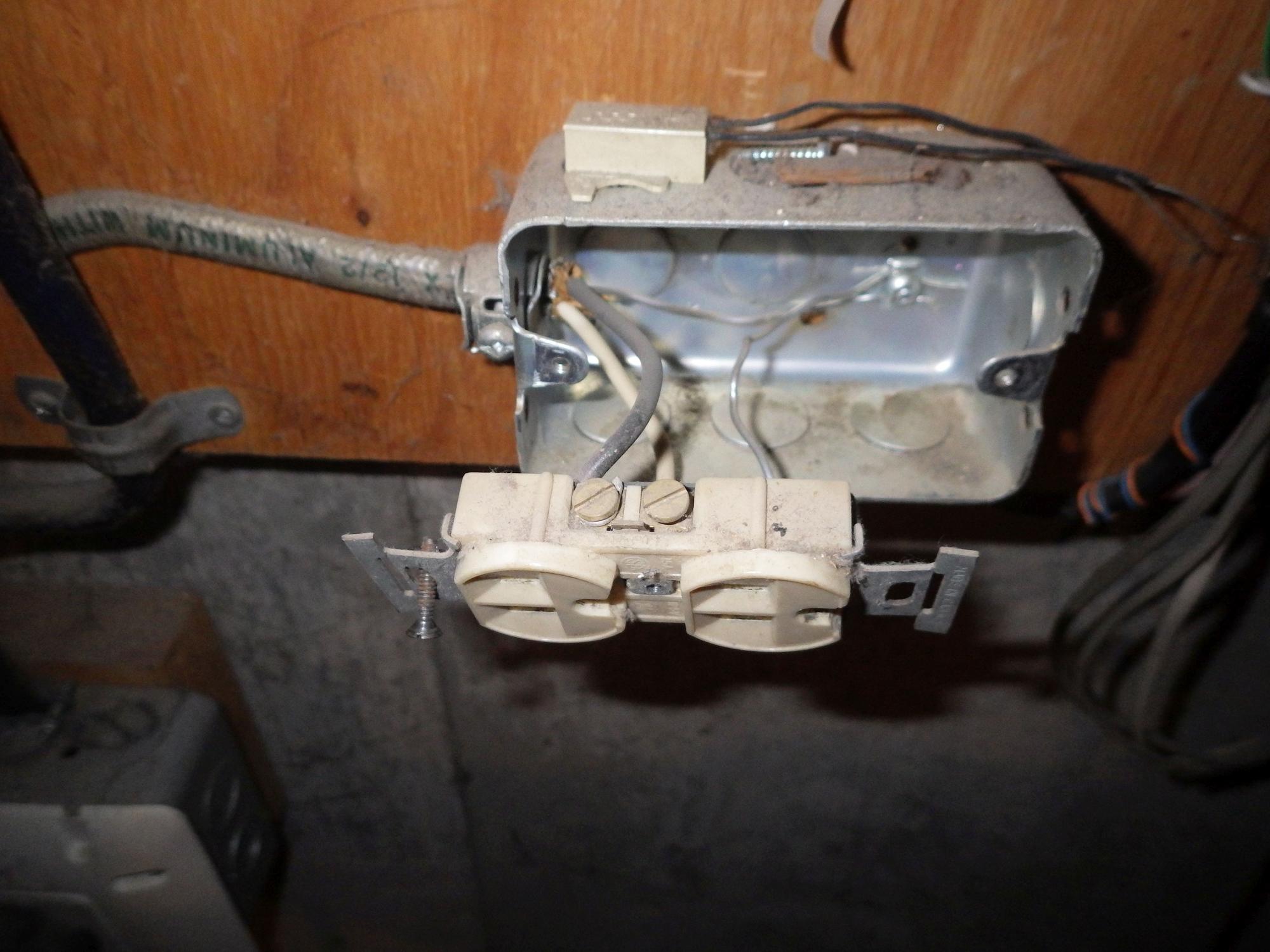

Very rarely have I encountered AL with cloth jacket insulator from residential home inspections and have photos, 2 or 3, on other HHD’s to support this. The conductors were not tinned copper.

Not Robert, but here goes anyway, most of the AL wiring I find has cloth sheathing, all has plastic insulation on the wires.
Yes I occasionally find one or two added AL wires in older houses, one way to tell is that all AL wire has a ground conductor, all the NM tinned copper I have seen had no ground conductor and rubber insulation over the wire, or it was knob and tube.
Once you have seen both tinned copper and AL you won’t mistake one for the other.
Almost all the homes with AL I find have had copper wiring added after, like basement development, kitchen upgrade, no one doing any wiring is going to use AL if they don’t have to.

Good example, but that’s not cloth wiring. That’s a rayon jacket. We are looking for AL with cloth covering on the individual conductors, which I do not think exists.
Yup, but the same question gets asked again and again, not everyone gets that sheathing is not insulation. It is hard to tell what the poster is asking about did the poster see sheathing, or did the poster actually look at what the wires were insulated with. And Rayon is a textile, cloth is made from textile, if A = B and A = C, then B = C. I am also totally in awe of Brad’s ability to perform chemical analysis from a picture, your talents are under utitized here, you could be a one man analysis lab.

Sure looks like rubber conductor insulation (not Thermoplastic) to me… Must be a Canadian thing?
https://www.nachi.org/forum/attachment.php?attachmentid=200749&d=1522079515
Nope, that wiring is in the US too. Thermoplastic insulation with rayon jacket. I don’t see it often. Most of it had a PVC jacket.
