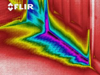

How does an air barrier stop this?
Better start digging into the effects of buildings with inadequate ventilation and how to test for it.
I have worked several jobs where excessive air sealing caused significant health issues of the occupants. One case killed the kids’ hamster, twice.
Leading reason Minnesota began requiring HRV/ERV’s to new construction early 2000’s…
