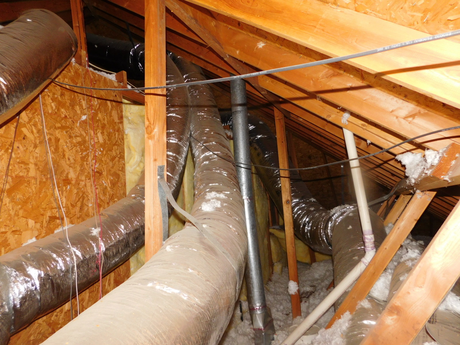

bathroom vents terminating at the soffit
Your local AHJ needs to get with the times.
International Residential Code (IRC) 2006
  **M1501.1 Outdoor discharge.** The air removed by  **every mechanical exhaust system** shall be discharged to the outdoors. Air  shall **not be exhausted into an attic**, soffit, ridge vent or crawl  space.
Your preaching to the choir I am well aware of the IRC codes.
Charlie, I see it all the time. Most all bath vent fans terminate into the attic around here, even my home that is 10 years old, with no problems, mold or moisture. Some are 20-30 years old, and still working fine. I believe this is an issue dependent on weather conditions and local climates and codes.
I recommended a few months ago at an inspection that two vent fans be vented to the attic or outside because the vent fans did not have any tubing or ducting. So, the repair persons ran tubes through the attic to a flapper/roof vent for both bath vent fans. Later, the owner complained that the flappers were always making noises, and her bathrooms were now colder than they were previously. The rooms got colder due to the “stack-effect”. She had the ducts removed, put short metal ducts above the vents into the attic, and solved her problem. Wind blowing on roof vents will suck warm or cold air out of the venting room. If I lived in a cold climate, I would not like that either.
Definitely not allowed by code here unless it is ducted through the soffit to the exterior somehow. I am guessing there is a climate factor making it OK in warmer places, but the result here would be instant condensation or snow inside the attic when the moist humid air hits the freezing attic air. Also an attic as big and open as the one in Charlie’s pic is pretty rare here, even high attics are filled with trusses.

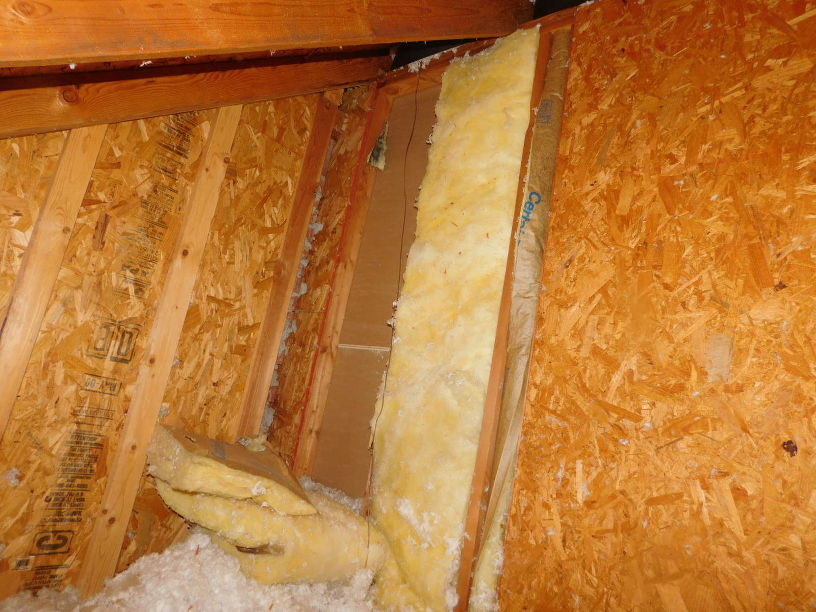

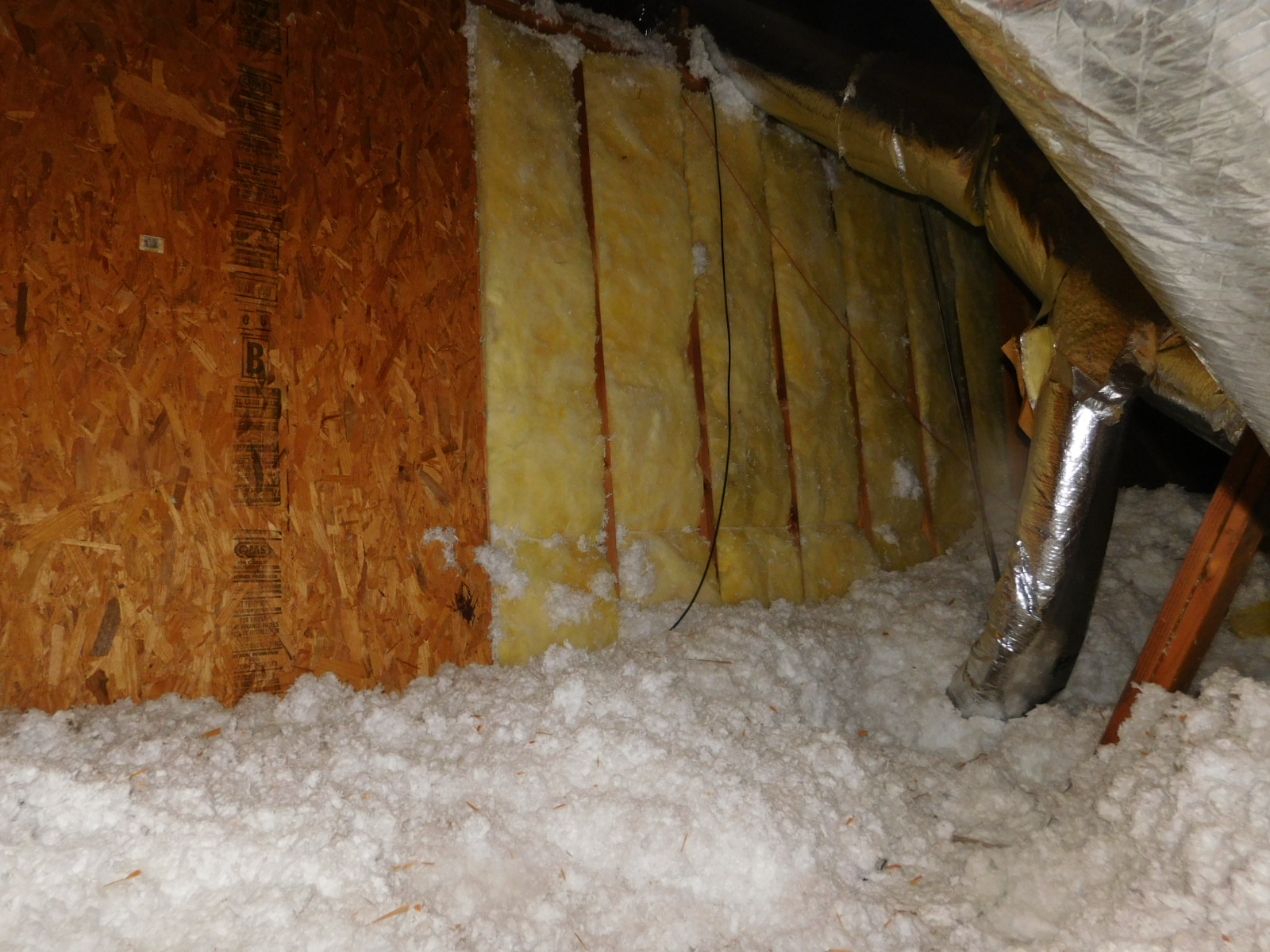

Yes Erik climate factor makes a big difference. I have been working in attics for over 40 years in one profession or another and I just don’t see damage from bath or kitchen exhaust fans in this area big attics or small ones. The only vent that the local AHJ requires to be external is the dryer vent. Here is a smaller attic from today. Two bathroom exhaust discharging onto the small area as shown.
This one built in 2000 and did have the kitchen exhaust through the roof. The lumber appears as shiny as the day it was installed.

Yesterdays and I have plenty more and in worse shape. This home just got remodeled so this venting is not a year old. Can’t wait to see what it looks like in a few years. :wink:
Yipper your in
Wis can not compare it to Okla BTW where were the vent fans from the damaged area. I see a soffit baffle were the soffit vents blocked with insulation
Yes they did not install baffles in every bay. :wink:
