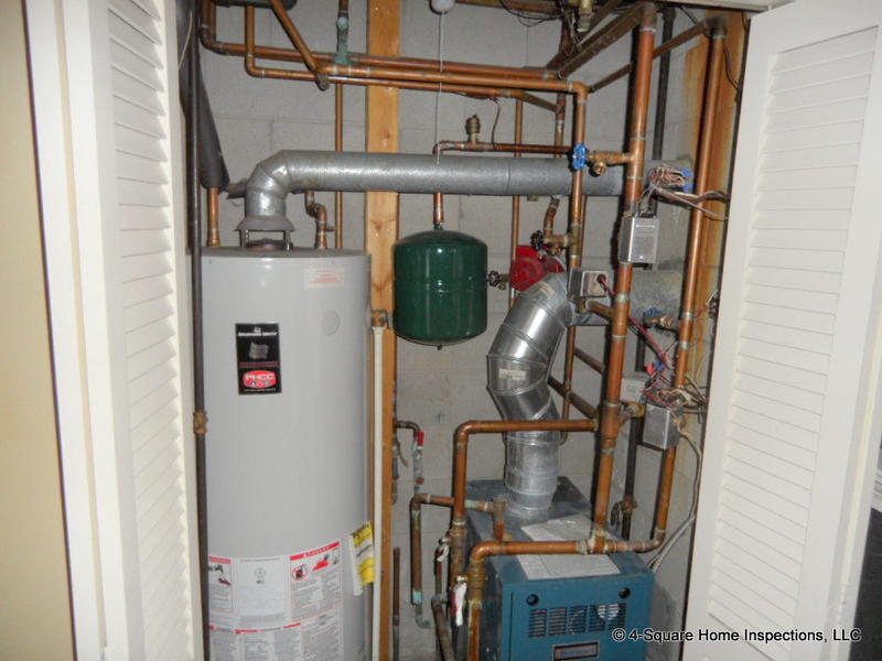

I’ve never seen this before. I found the old flue in the corner of the basement, but the new flue has a direct connection to the boiler. Is this even legal?
If you opened the front cover of the boiler you would either find a draft inducer or not.
If you find the draft inducer fan your flue is fine.
Nope, no draft inducer motor present.

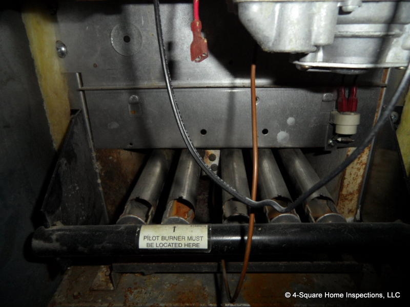

Looks like there may be one behind the cover .
Do you have a pic of the interior?
In any case I would be checking the boiler’s installation instructions.
I think that is a draft inducer in the upper right hand corner.
Get the model number and check the owner’s manual.
Does not look right for a Burnham Boiler.
Note it…
And let the Heating Technician figure it out…
I think that is bottom of the gas valve
I think you are right Wayne.
Good call.
