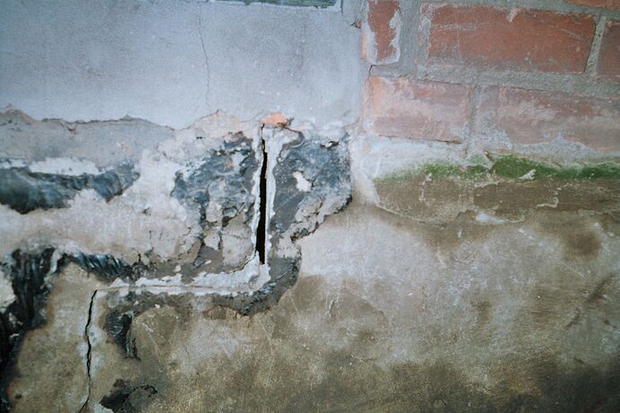

Example 4 photos, step crack in bricks near corner
exterior crack in block basement wall, was one reason basement leaked and had some mold and efflorescence on some of the blocks inside.
This senior lady was almost bs’d big time by… yeah you guessed it, an interior basement system company who lied to her and told her she needs piers and an interior drainage system for BIG $$$$$, no way man, nope.
Her husband had previously hired a moron (you should be able to see tar outside in small area where crack is), well they backfilled with all the same crap expansive clay soil = big mistake, didn’t last long at all = waste of money., gotta be done correctly
we did this small section and 2’ on front corner because there was also 2 more exterior cracks, one on side corner and 1 on front corner
