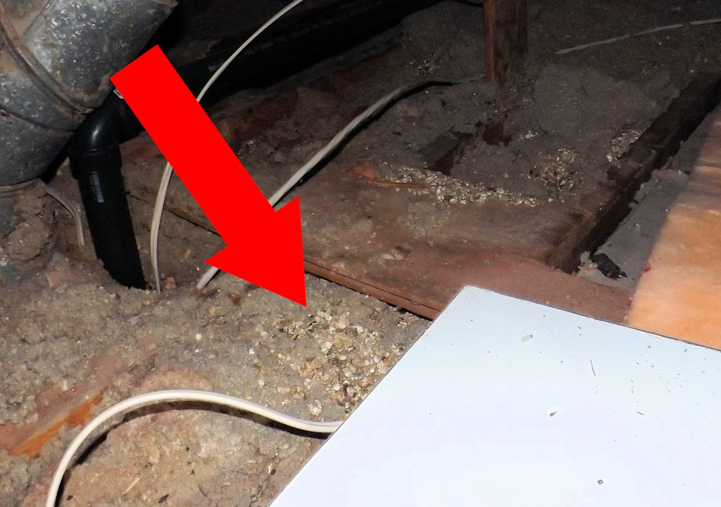

Attic Insulation
There appears to be Vermiculite insulation in the attic. This type of insulation may contain some trace amounts of asbestos. Although testing is needed to confirm this, it is best to assume it may contain asbestos and should not be disturbed. Remediation or removal of the material is generally needed only if disturbed during remodeling or repair in the area, and the process can be invasive and costly.
