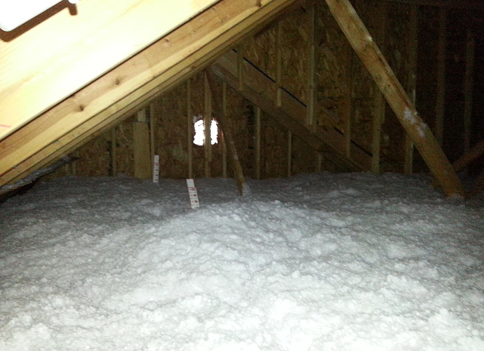

The picture attached is of an attic I inspected this past summer. Lots of times the attic is under insulated in my area. This attic was well insulated, with 12 inches of blown in fiberglass insulation. The standard for our area is roughly 10 inches so he has a well insulated attic space. The attic space was well ventilated and had an even amount of insulation throughout.

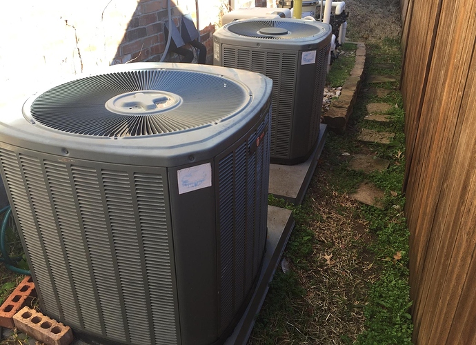

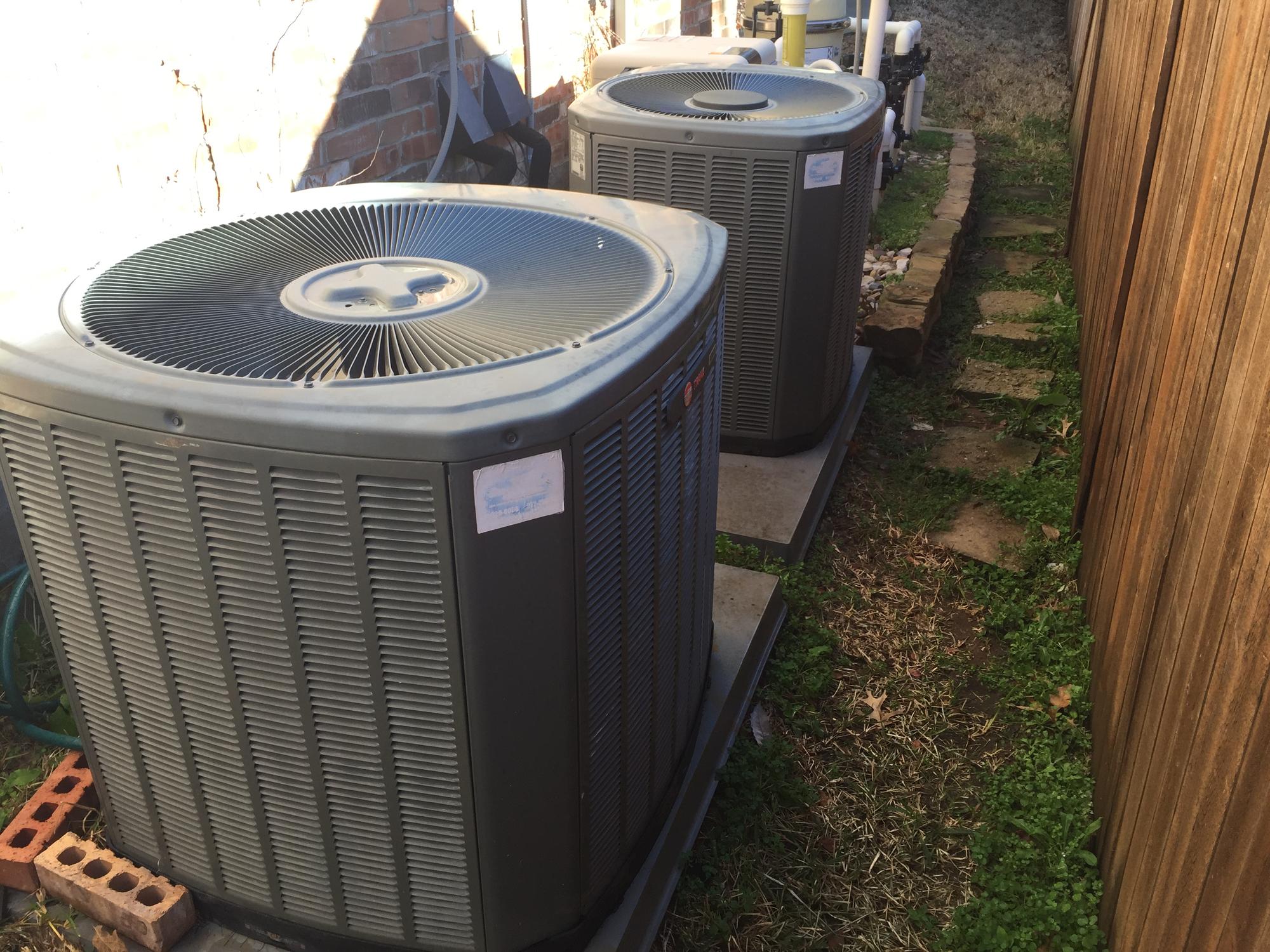

These are the outside air-conditioning compressor units. Both are mounted on pads and are properly supported and level. The electrical disconnect is in sight of the units and the refrigerant return lines are insulated (although not completely visible in this picture). The units appear to be operational and are clear of debris or obstructions which might affect airflow.
