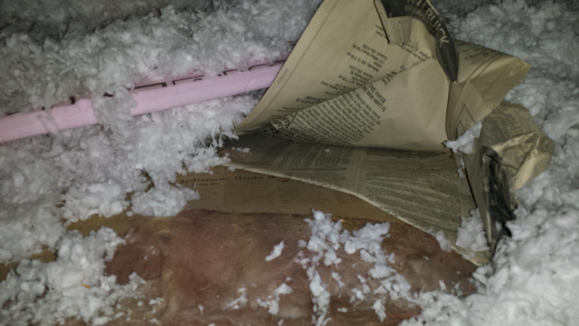

I took these pictures of the attic in the house that I am renting. As you can see the attic in insulated with 2 rows of non-backed batts of insulation with several inches of loose fill cellulose on top. I would say that this attic is properly insulated but improperly ventilated. There is only one gable vent and no sign’s of any venting pipes for the bathrooms, kitchen or dryer. There is also a large exhaust fan installed upstairs but it is only vented into the attic and not out of the house.
During the visual inspection of the house I am renting I found that both the front and back doors showed lack of weather striping. One window showed signs of condensation and old and diminished calking around all of the windows. In the attic there was 2 layers of non-backed fiberglass batt insulation with news paper on top and several inches of loose fill cellulose on top of that. I was not actually able to enter the attic because of the insulation and no place visible to walk. From what I could see from the ladder there was no vent pipes for the upstairs bathroom or the exhaust fan installed upstairs and only one gable was vented.
