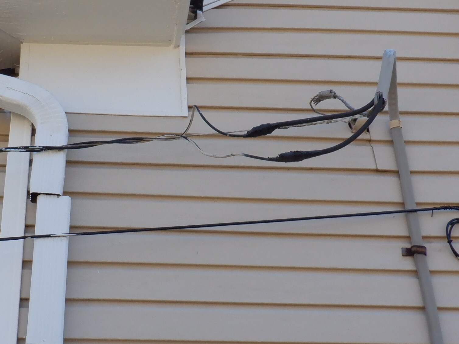

Today’s inspection had what looked like a 125 - 150 amp service feed connected to what looked like 4.0 wiring and a 200 amp main disconnect. Is this right? My thinking is that it would be hard pressed to trip the 200 amp main.
If that is the feeder from the power company, then what they do is OK.
A few other issues though!
The utility service line follows a different standard because they are always open-to-the-air, ensuring that heat is rapidly dissipated. Your real concern is the lack of clearance from the building and, in particular, direct contact with the metal downspout.
Yeah, I noted the distance to the building and the possibility of energizing the roof drainage system. I just didn’t know about the different wiring sizes. I guess that since it’s on the other side of the meter it’s not necessarily the homeowners concern.
Many years ago, I called up the utility over a similar concern. I learned that the utility company has a code exception to size the service drop however they deem appropriate.
The weatherhead on the SE cable is missing. Nothing wrong with whatever size drop conductors the POCO uses upstream of the service point.
Utility companies don’t need a code exception. They are governed by state tariffs in the US. It may be different in Canada.
I concur, George, but the PoCo overhead service cables requires proper clearance.
The SEC cables are clearly contacting the aluminum downspout. Wouldn’t it be within their jurisdiction to fix it?

#4AWG aluminum Tri-Plex is common coming from a standard 25kVA transformer. The transformer is not typically fused on the secondary. It is fused on the primary. The typical fuse Amperage rating on the primary is 3.5-5A. The transformer secondary current rating is approximately 104A so #4 aluminum in free air is adequate.
All electrical equipment ratings in the US are extremely conservative. That’s why they are so inherently safe. Transformer failures resulting from non-fault overloads are rare. Service drop conductor failures from non-fault overloads are even more rare.
A single 25kVA transformer will serve one to seven houses, with 3-4 being common. Therefore, the transformer would likely be overloaded before the service drop conductors. That means even a #4 is usually bigger than is needed. As you can see, utility companies are much less conservative than the NEC. Electrical fires resulting from non-fault overloading of electrical systems in the US are rare.
