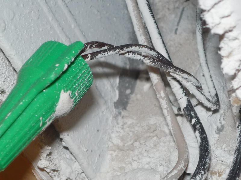

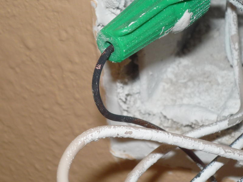

I came across what has all indication to be a home that has chinese drywall this afternoon. My question to you folks is: How should I note this in the report? I advised the client and showed them what I found. I do not test nor am I interested in doing so at this time. My only concern was the client’s knowledge of what is suspect in the potential home. This is why I ask the question. Since I don’t test for it, I really don’t know beyond the reasonable doubt that it exists. But, The copper wires are black, the home was built in 2007 and there is a new air conditioning system manufactured April of 2009 installed. The copper (liquid line back closest to the wall is black. I pulled the electrical panel cover and wires are blackened and a couple of receptacle wires are black. I will post photos later this evening. But, my concern is a potential problem with any statement I make on the report. Any advice will be deeply appreciated. By the way, the buyer said to just stop the inspection early and do not continue. I explained to them that I could not make a decision for them and was in no manner making a legal statement by pointing out the several areas of blackened copper wires. All plumbing throughout the home is plastic so I couldn’t fine blackended copper except for the electrical system. Thank you for the help.

Here are the pictures I spoke about earlier. They sure look suspect of chinese drywall contamination but, I am not an expert and only have the State of Florida DOH as a guide. If anyone cares to offer some advice on how I should address this in my report for the customer I sure would appreciate it. Thanks again.
here are some additional pictures…
“The home has some telltale signs of Chinese drywall - the AC coils have turned black, the copper wiring has turned black, etc. Without actual testing the presence of Chinese drywall can not be substantiated.” Inform you client that destructive testing would be needed to look at the markings on the back of the drywall, and that you are not allowed to cut holes in the wall. Put a link in to the state web site that lists these items as back up and tell them they need to contact the builder. Right now it is the builder who has to prove he does not have it. You may want to include something that lets your customer know that, while he has signs of Chinese Drywall, there are other factors that could also cause the wires to turn black and the AC could to turn black. Will it kill the sale of that home - probably. But you have a job to do, so do it. We can only give the information as we know it.

The a/c copper line is the existing from that “elbow” you see back to the wall. Someone has replaced the unit. The home is 2007 and the a/c air-handler is 2009. The condensing unit is original. Both different brands. That was what first raised my suspicion and I proceeded to check for further damage or discoloration to the electrical system.
