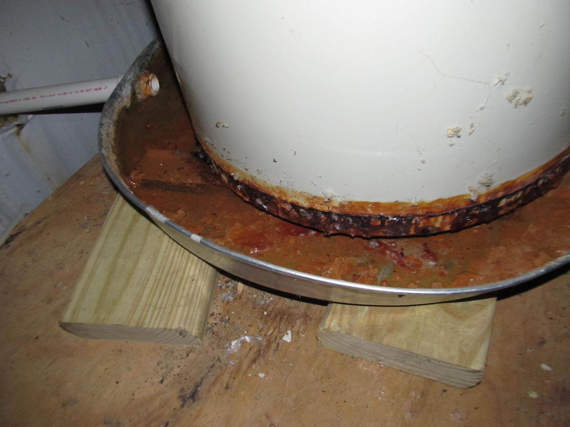

(Jude E. Silva, 21181) #16
Observed this electric water heater with rust in the drain pan and on the bottom of the unit itself. I notated it in my report, included this photo, and let the buyer know that the unit was most likely near the end of useful life. In addition, I recommended this unit or replacement unit be placed on stable secure flooring.
