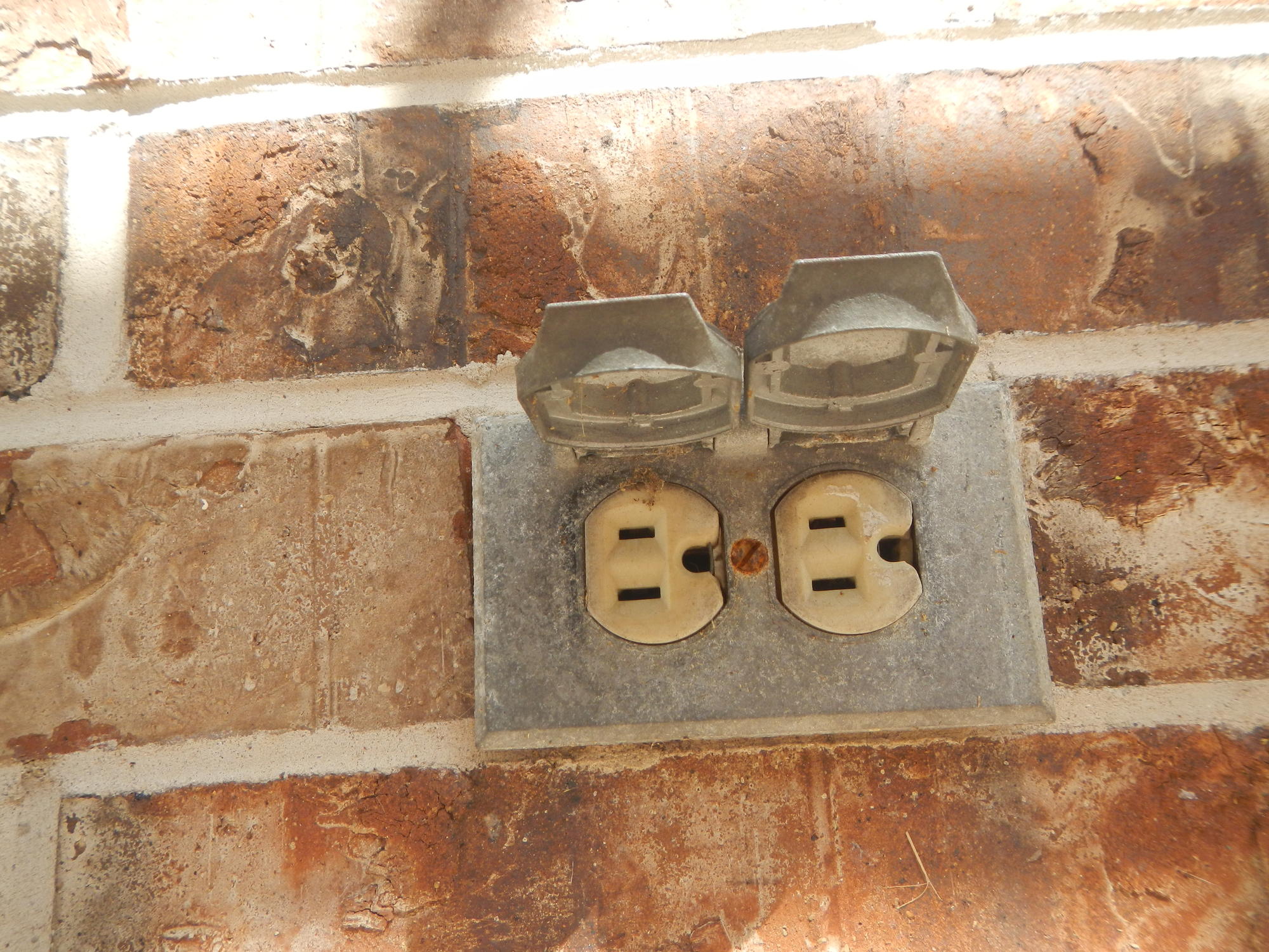

Inspection of exterior outlets. No outlets at the front or rear of the home. Two outlets available are outdoor receptacles but are not GFCI. Recommend replacement of both outlets with proper covered outdoor GFCI receptacles.

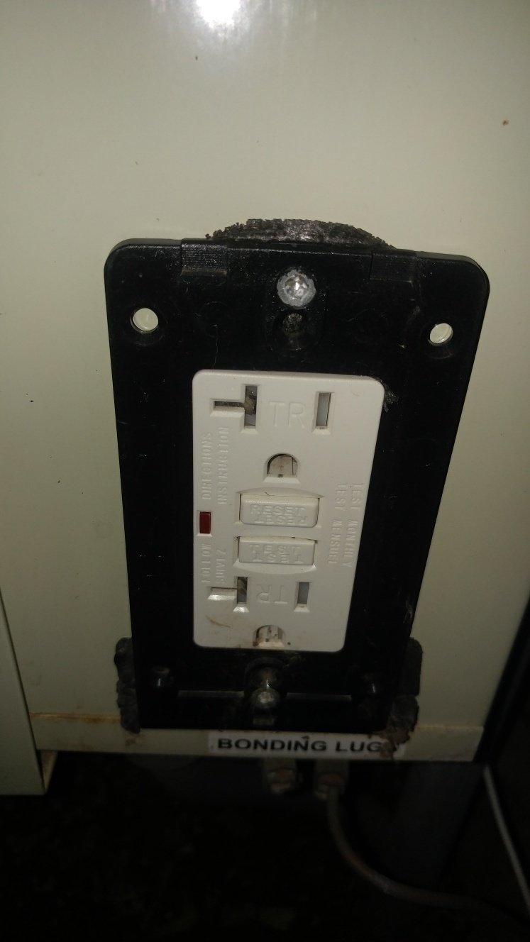

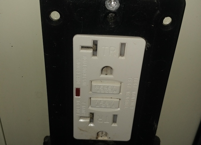

This is a picture of a Outdoor GFCI outlet near a deck area at my home. This outlet is missing the protective or while in use cover. It is working right now. I would note in the report the location of the outlet and the fact that it is missing its cover. This is not a defect but needs to be addressed as it will cause unnessary tripping of the outlet due to spashing, etc.

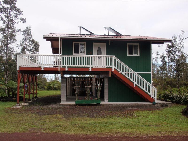

deck in hawaii are a very overlooked inspection point it would seem. Both on the home owner and inspector side. Within recent years the number of deck tradesman and other have quickly repaired or covered things up is astounding.
(See attached picture)
In this pic a few items were of concern.
  1. footing. (in ground sand) only 4 feet deep and with bracing on one side.
*Its common through-out the hawaiian islands to see decks and house 4x4 shifting on newly placed “foundation blocks”
Bottom line: Pay attention to details and do it right

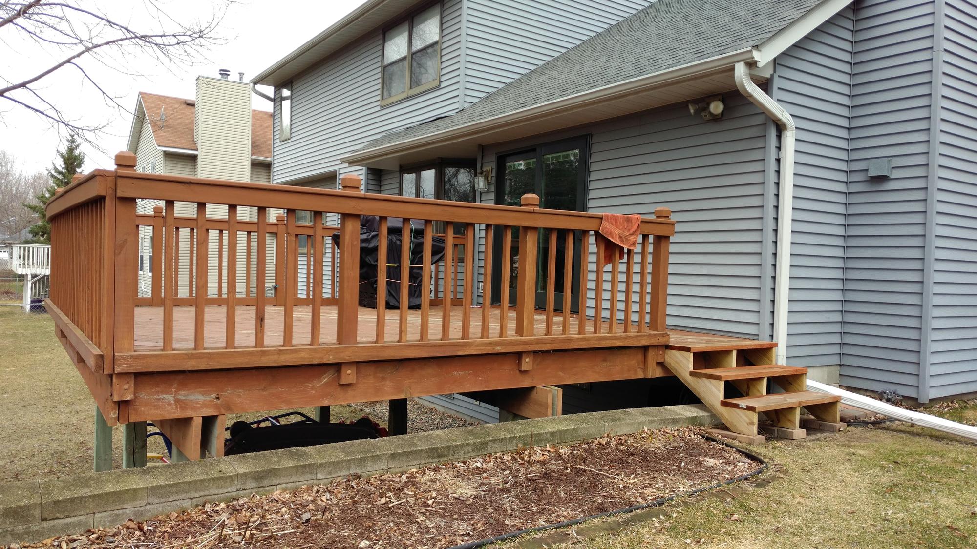

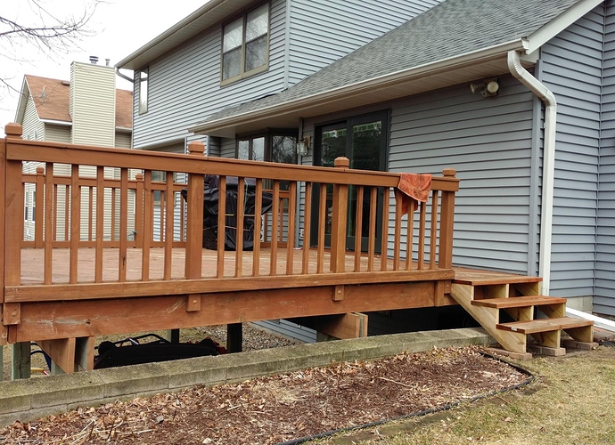

The image above depicts a deck properly attached to a single family home. The deck has diagonal boards with properly spaced screws attaching the boards to the joists. While the deck is weathered, the wood is not rotted. The ledger board is properly flashed on both sides. The girders however, are notched on both sides, holding the beam, which has been noted. The railings and guardrail infill sizing is proper as well. The stairs do not have a handrail, but there are only three risers.

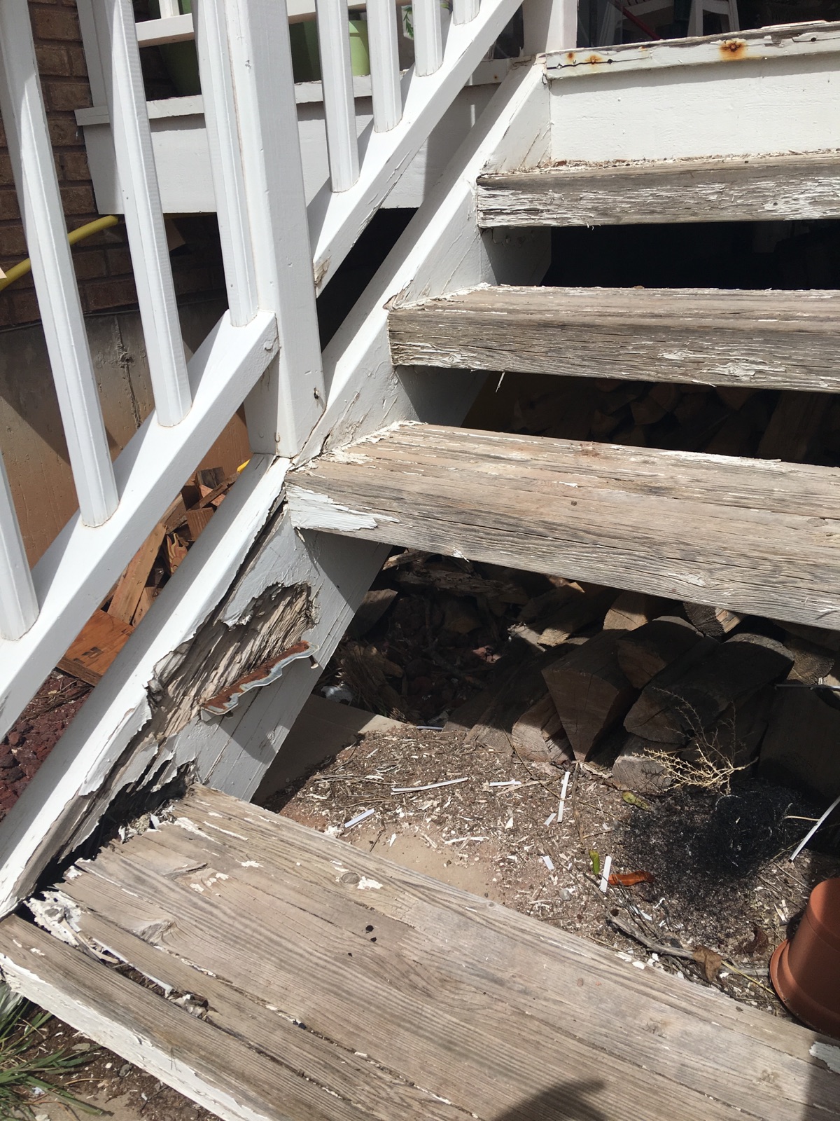

Steps going up to backyard covered deck. The wood is rotted through and did not pass the pick test. The missing step shows that the steps are not held in place with bolts, but rather has been held in place with nails and glue. Not considered safe for use.

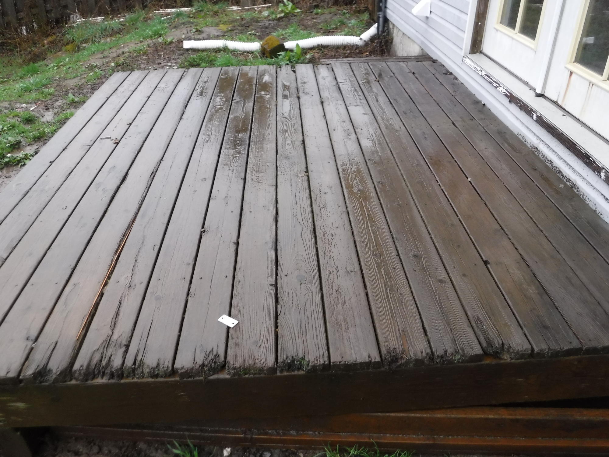

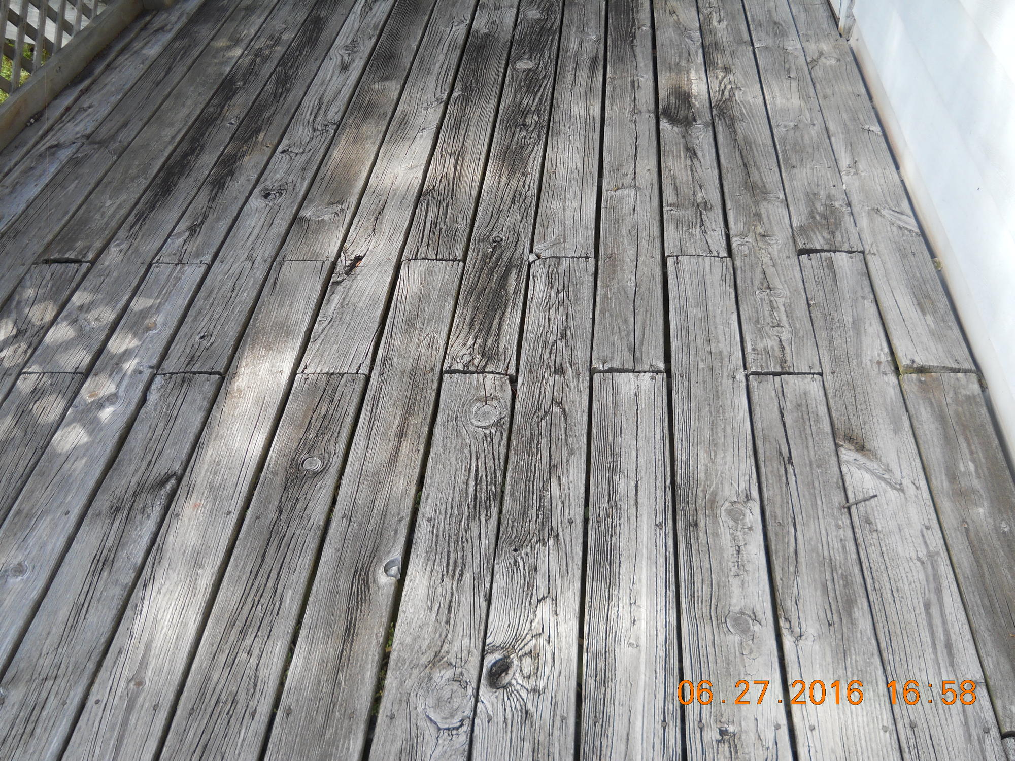

I have attached a picture of decking for this assignment. As you can see, the decking was never sealed or painted. This has allowed the decking to splinter and crack significantly, causing unsafe conditions.

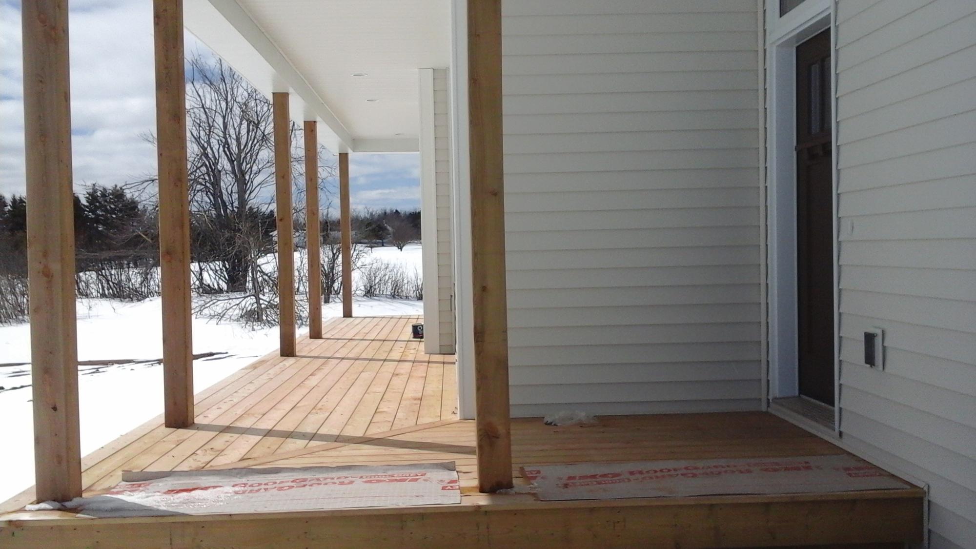

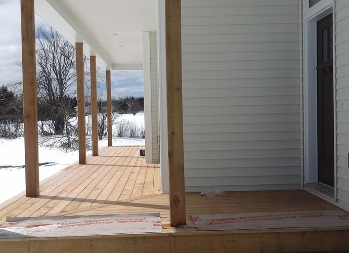

This was a newly constructed deck that was inspected. This deck was less than 30” from the ground not requiring it to have a guardrail. This deck was missing a set of stairs to the which was recommend. There were 2 outlets on the front of the home, both GFCI protected and both had proper while in use covers. Deck sat on concrete pillars. Ledger board was properly attached as well as joists. Flashing, soffit, and trim were all in satisfactory condition.
