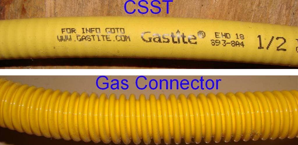

FAC - flexible appliance connectors are known in the industry as corrugated stainless steel connectors (CSSC). It seems like someone is trying to make things confusing.
Bends will reduce the gas flow. Very sharp bends could weaken the tubing.
Corrugated Stainless Steel Tubing (CSST) & Flexible Appliance Connectors (FAC)
