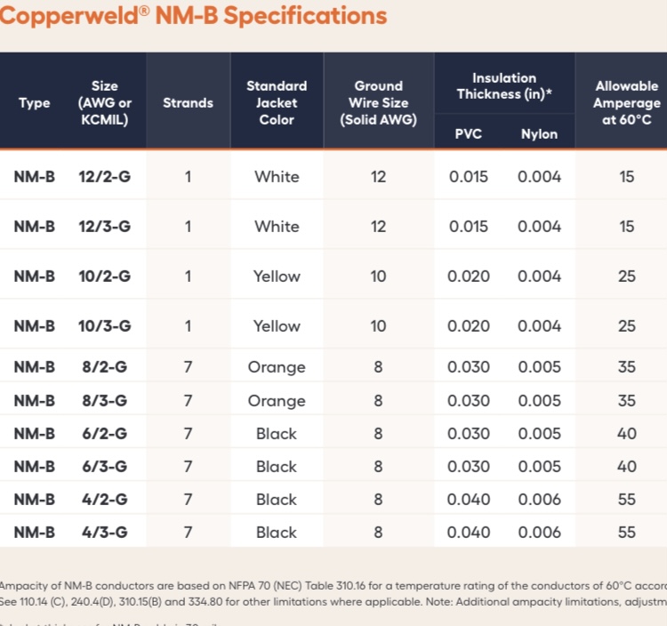

With some of the illiterate knuckle draggers working construction it wouldn’t surprise me at all if the “electrician” fished the wires based on sheathing color, instead of the printed size or the feel of the wire.
I think Robert nailed it. It explains everything except the missing GFCIs and swapped CO/Smokes.
That’s really interesting, I haven’t seen CCA (copper-clad aluminum) romex in the field before, but that appears to explain what is going on here. At first read I thought the same as others, possible mislabel and overpull for voltage drop.
https://inspectapedia.com/aluminum/Copper_Clad_Aluminum_Wire.php
except the oversized stranded copper conductors as well. But this is interesting… Didn’t know they were making that again.
Good call on the copper clad Al wire.

New construction has started using copper clad aluminum lately. We just had a discussion on that recently in a TPREIA class.
Interesting how copper clad is a safe option. Knowing that copper and aluminum expand/contract differently, seems like it would break down the wire over time, and lead to fire hazards again. I wonder if they will be requiring these to be replaced 20-30 years from now too??

There proposals to allow 14 AWG copperclad aluminum for 10A lighting circuits in the 2023 NEC, there is one huge problem with the wirenuts, Wingnuts & other like connectors is that they are listed for copper connections only. Copperclad is one material I don’t care for, only thing like even less is 10AWG & 12AWG aluminum conductors which is still allowed by the NEC, just not made anymore.
