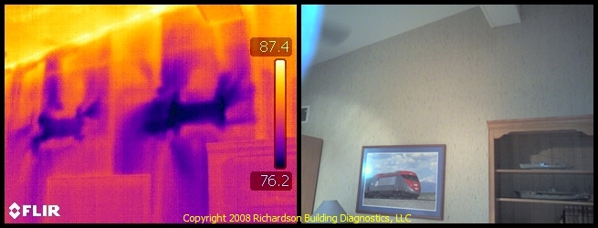

Here is a “Cool” image of leaky ducts.

Kevin great photo. Q. is that an exterior wall or adjacent to a garage.
Best
Ron
This is an interior wall, which was adjacent to a utility room with a split-system. The main plenum ran across the length of the wall seen in the digital image.
This home had been renovated and this section was an addition. It was very odd, but the main plenum had two legs going into the wall cavity. That’s where you see the cool air dispersing from the ends of the duct legs. The “pattern” of the atypical thermal anomaly is consistent with cool air flow (leaking air).

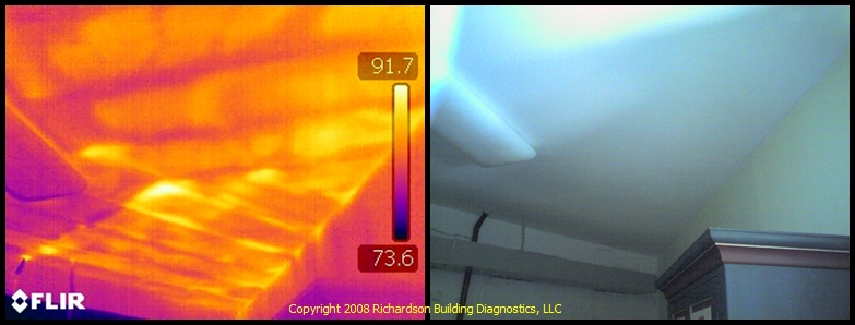

The image below depicts another atypical thermal anomaly consistent with mis-applied insulation. This is the ceiling (flat roof) area of the utility room adjacent to the bedroom in the previous image. If you look closely at the digital image, you will see the main plenum in the background.

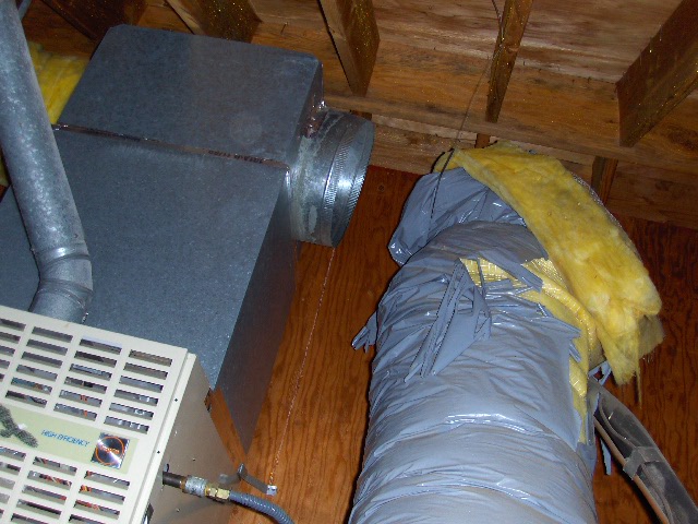

Say brian just had to post this photo.
Residential duct systems, from 20-40% of the air moving through the air handler (fan) does not come from or go to the areas it was designed for!!
Your words are on the money.
Best
Ron
That little bit of leakage should be “no problem” since by the label it’s a high efficiency unit…so owner can afford to lose a little!!!
