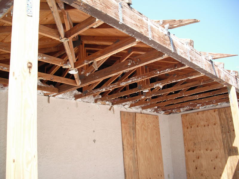

Photo attached is what can happen to a open patio that has been enclosed without the homeowner pulling a permit!

Knowing that a permit was pulled is a start, but many have not been closed. (no final inspection)
You can always ask if plans are on file for the permit and any supporting documents. Notice of Acceptances and certificates and even pictures are stored in the files. Termite treatment, insulation cert, truss plans are to name a few.
