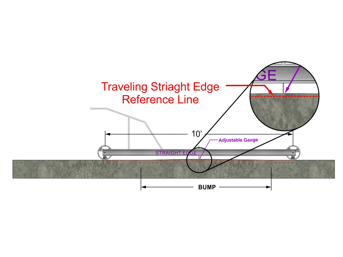

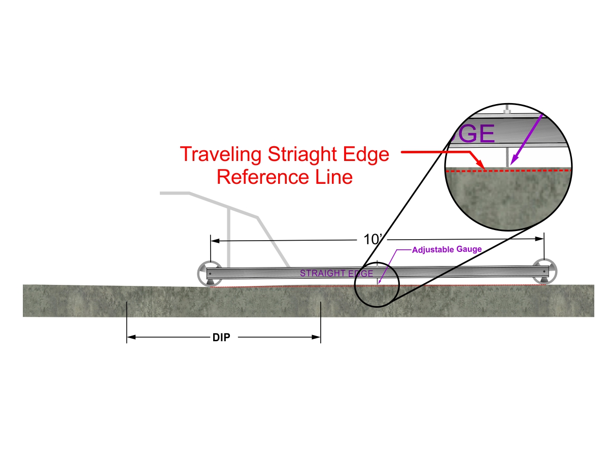

Here are two graphics showing a traveling straight edge, one graphic detects a bump and one shows a dip. The adjustable gauge (bolt) in the center is set by stretching a string line between the wheels and off setting the gauge by whatever tolerance you want 1/8", 1/4", etc.
THANKS Randy! :slight_smile:
