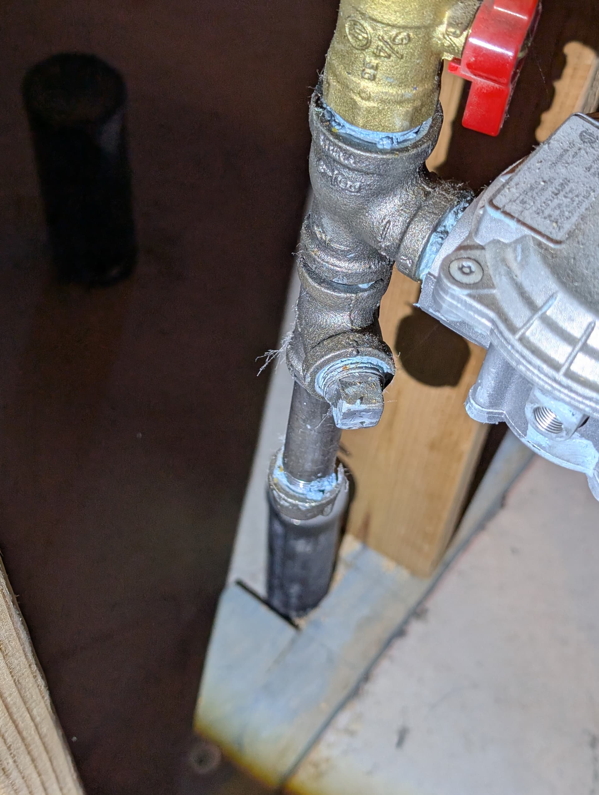

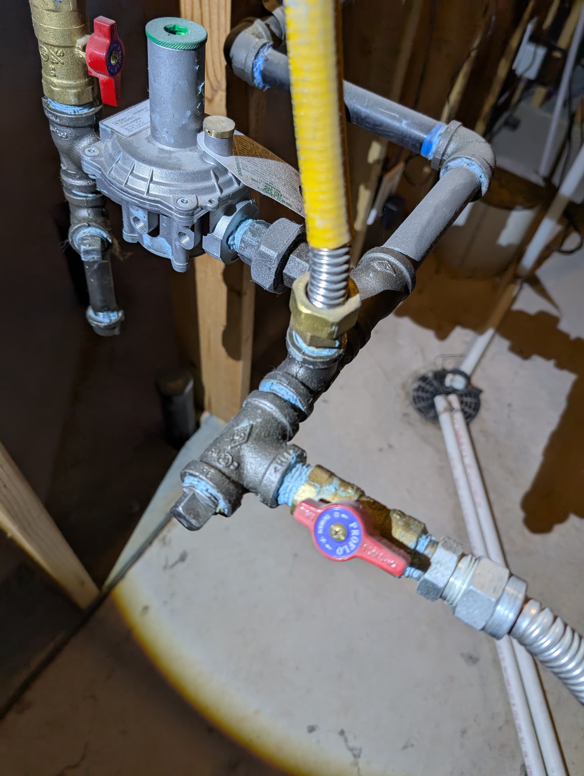

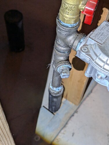

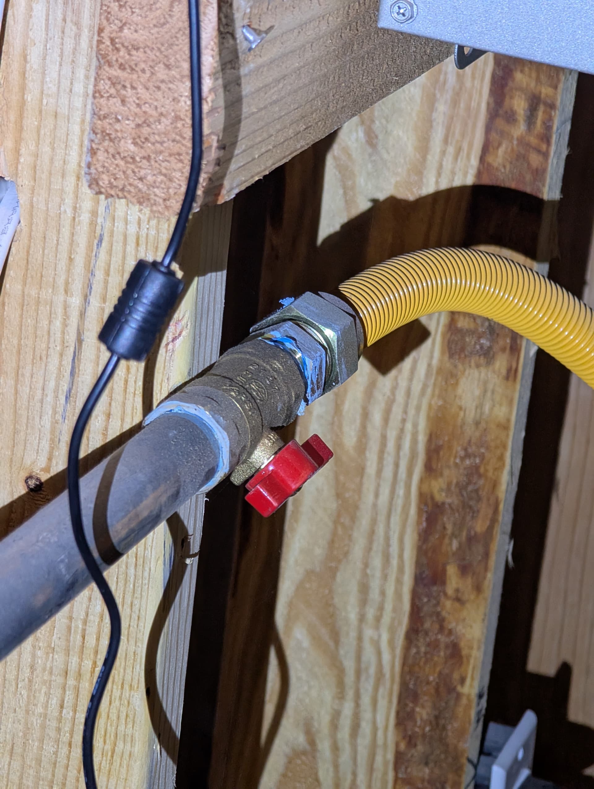

Thoughts and maybe some clarification on my understanding of this.
This is how I understand it: each gas appliance should have its own gas leg/sediment drip. This has one on the main line, but the furnace and tankless water heater do not have one.
Would you write this up?
G2419.4 (408.4) Sediment trap.
Where a sediment trap is not incorporated as part of the appliance, a sediment trap shall be installed downstream of the appliance shutoff valve as close to the inlet of the appliance as practical. The sediment trap shall be either a tee fitting having a capped nipple of any length installed vertically in the bottommost opening of the tee as illustrated in Figure G2419.4 or other device approved as an effective sediment trap. Illuminating appliances, ranges, clothes dryers, decorative vented appliances for installation in vented fireplaces, gas fireplaces and outdoor grills need not be so equipped.
I would put it in the report as an installation defect. Maryland requires me to recommend the yellow CSST bonding be checked by a Master Electrician.
My personal opinion that the sediment trap before the regulator is all that is needed. I would most likely not say anything in my report. But, this is me and you might have a differeing opinion.![]()
I agree with Scott.
I agree as well. Not a problem as there is a drip leg installed.
The CSST is another issue.
There are install manuals that may require traps, ie. such as equipment installed on the exterior in cold weather weather zones primarily where condensation will occur from moisture in the gas exposed to temperatures below its dew point. This keeps the moisture out as well as sediment (rust) inside the pipe because of the condensation.

I think your understanding is correct for the most part. If you look up the manuals for the appliances, they will likely state that a drip leg/sediment trap be installed as close to the appliance as practical. In your opinion, is the one in your application installed as close to the appliance as possible? That said, it will likely never be an issue, until your client sells the home and the next inspector writes it up. ![]()
If you ever want to see how effective a sediment trap is with modern appliances, take one apart. Tell me what you find.
Sediment traps were designed and written into code when gas was filthy. It’s not like that today.
It’s there as a common sediment trap for all of the appliances. It’s the first thing that gets hit before gas is distributed to the appliances.

Do you have a good reference for more information on CSST? I understand bonding is required. However, we do not see it much in Utah, as it wasn’t allowed until more recent years and builders rarely use it. That line looks to have been installed more recently and probably was done by the home owner.
I included in my report this comment about it: “A CSST gas line was observed supplying the kitchen range. The installation appears to be a post-construction modification and lacks a visible bonding connection. Recommend further evaluation by a licensed plumber to verify that the installation meets current safety standards and bonding requirements.”
