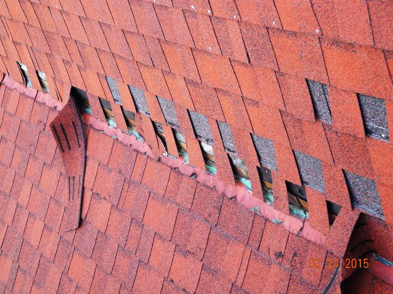

Image of missing aggregate on some 3 tab shingles from an inspection a couple weeks ago.

This is a Boston Hip the roof was redone a year ago by a licensed roofing contractor, it is in great shape with no pop up nails and the boots/vents were done properly.

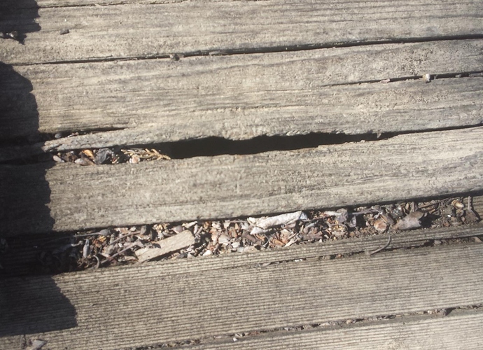

Here are some pictures of a California shake roof where the elements and organic material have destroyed the roof. Surprisingly enough there was only an area on the inside the size of a fist where the leak showed up. The client could and wouldn’t believe that the roof covering was shot. All I can say is thank goodness for her that we’re in a drought. Notice the organic material and the holes all the way through the shakes and underlayment.
