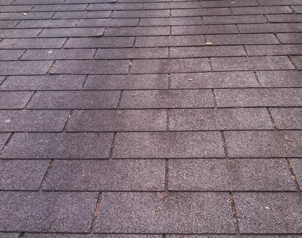

This is a photo of a 3 tab asphalt shingle roof. It has no visible defects and appears to function properly at the time of this inspection.
Shingles manufactured in North America have mats made of interwoven fiberglass strands, so you may also hear them called “fiberglass” shingles. A modern shingle consists of a fiberglass mat embedded in asphalt, and covered with granules on the surface that faces the weather. The mat, asphalt and granules act together to form a durable, flexible and waterproof assembly.

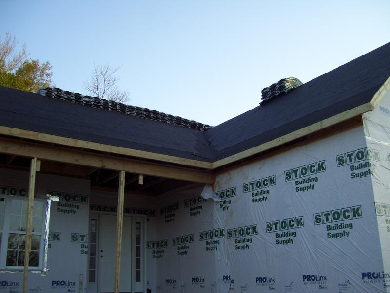

I’d like to shate a few pictures of a roof being installed on a new home. It shows the general felt underlayment, the valley underlayment . There is a section where two roof planes meet in a low height difference and are soon to be step flashed when the shingles are installed.
thanks,
Nat
