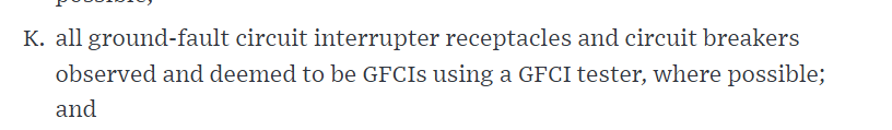

Yes, as long as you’re confident the reset is fairly close. I’ve had the “hunt for a reset” once on an inspection, I won’t do it again.
Check on your state SoP. NACHI SoP runs afoul a bit in my opinion.
Shall inspect
Shall report in need of correction.
Funny how it does not mention to report if GFCI is not present. Personally, I make mention when they are not present. And then I say the client may consider upgrading for additional safety. Problem with my technique is the upgrade recommendation could go haywire if we don’t show some restraint. Where does it end?
Maryland SOP (ASHI) does not tell you to report if GFCI is not present. Locations are different depending on the code cycle (year) of build or remodel. Do you report on missing AFCI? Probably a more important device and yet deleted from many local codes.
