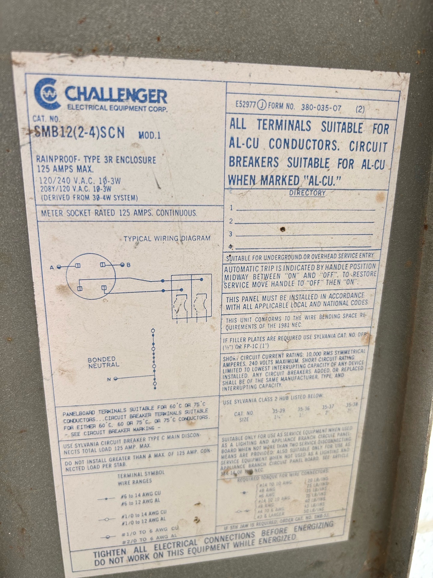

Robert,
I’ve seen this situation a couple different times recently: There was a disconnect panel (older) rated for 125 amp max. They had a 100 amp “service disconnect” breaker, but added another breaker rated for 125 amps. Both breakers still seemed to be connected and flipped to “on.” Both are single family homes. Both seemed like they were trying to upgrade from 100 amp to 125 amp. They can’t leave both breakers in there, can they? Is there a way the 100 amp breaker is somehow being bypassed? And they were just too lazy to take it out?
Thanks for your help.
Do you have any photos?
Looks like you have two service disconnects. Were there two panels in the home?
