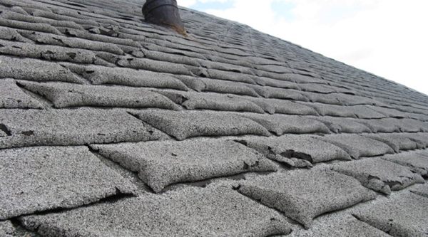

I don’t care how many shingles you laid… from my experience, asphalt shingles absolutely melt (curl, cup) from improper ventilation. I’ve never seen asphalt shingles hold up more than ten years to a fully insulated attic with no venting. They simply cup and become brittle due to the attic cavity becoming somewhat of an oven.
This is one of many images that I have that prove my point…
This is a twelve year old roof with no ventilation…
Tell me what caused this roof to deteriorated at an early age?
So do you agree that by ventilating a roof it decreases the attic temperature thus extending the life of the shingle?

If that is a 12 year old roof why is there a cast iron vent stack coming through the roof with no flashing, how would that pass code and who uses cast iron anymore
I never stated it was a 12 year old home. Here you go again…
It’s a re-roof. Have you ever replaced defective roofing shingles? I never laid a shingle in my life, but I’ve inspected many roofing materials with improper venting, improper flashing, improper drip edges, improper weaving, and the list goes on and on and I’ve got images of them all.
Well good for you Dave, glad your an expert. Would you say the shingle’s failed on that roof solely due to the lack of ventilation or solar heat gain or a combination of both.
Both…

Effect on Shingle Life
In general, shingles installed on unvented attic assemblies operate at a slightly higher temperature. This has impacts on the durability of roof assemblies. A 2 or 3 degree F. rise in average temperature is typical for asphalt shingles and a corresponding 10 degree F. rise in average temperature for sheathing (Parker & Sherwin, 1998; Rudd & Lstiburek, 1998; TenWode & Rose, 1999)
All other things being equal, applying the Arrhenius equation (Cash et.al, 2005), a 10 percent reduction in useful service life should be expected. This is comparable to the effect of the installation of radiant barriers. What is more significant to note is that the color of shingles and roof orientation have a more profound effect on the durability of shingles than the choice of venting or not venting (*Rose, 1991](http://www.buildingscience.com/documents/digests/bsd-102-understanding-attic-ventilation/bsd-102-understanding-attic-ventilation/bsd-102-understanding-attic-ventilation/bsd-102-understanding-attic-ventilation/bsd-102-understanding-attic-ventilation/f/bsd-102-understanding-attic-ventilation/?full_view=1#Rose_1991)) – double or triple the effect of venting/non venting.*

David is right in his statement.
I have seen this even in a climate as Montreal Quebec.
A cold climate. I think zone 3 if I am not mistaken.
I have seen melted elements of shingles often and also seen roofs that have not lasted 10 years.
In Quebec it is Illegal to sell shingles with 10 year grantee they must be 15 plus.
I have seen melted gum strip ( self seal ) part of the shingle.
I have also noticed the weakest viscosity of the shingle run It looks like tar or even oil dripping down a shingle.
I will not put words in his mouth but will try to clarifie his statement by saying that the shingle was not melting but parts of the system ( elements of ) the shingle melt and show sings of dripping running, etc.
There for the shingle is dry , curled up or down , self-seal broken, dried up leaving weather possibly enter the decking and into the attic and thusly the home.

Robert, as I said in my earlier post my intention was not to challenge Dave but to point out that many experts in the field of building science have concluded that the lack of ventilation is only part of the problem with shingle degradation and many instances a small part. I was just trying to start a conversation about this topic and unfortunately I think Dave got a little sensitive about it. To bad because that was not my intent and I’m sorry you see it that way.
Take a look at the information I posted. Studies have shown that ventilation or the lack of it only decreases the shingle temperature by 2-3 degrees and the roof deck by maybe 10. And, as I said I’m not saying it’s not going to contribute but it’s just part of it.
More shingles are damaged by color, number of layers and orientation of the roof than by lack of ventilation. Just trying to open the discussion to other possibilities and hopefully we all learn from it.
