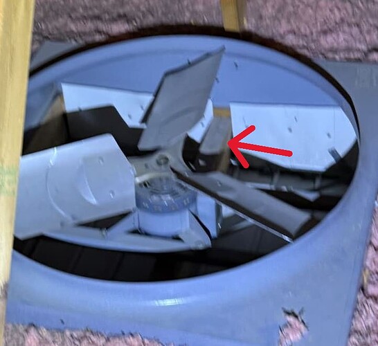

Hallway Fan Venting in the Attic
During my inspection in a 1995 property I discovered a hour fan venting in the attic. I have it noted in my report just wondering if the condition is acceptable
Google “whole house ventilation fan”. I see no issues when the attic has proper ventilation.

I agree with Thomas. That is a whole house fan and is likely original to the home. You won’t see many of those in new-construction or modern construction homes, but they were popular several decades ago, especially in homes that did not originally have central HVAC.
9 times out of 10 the installers cut the bottom chord to install the fan, which results in a recommendation for a Structural Engineer. I think I see part of it in your picture, but that’s always the first thing I look for whenever I see a whole house attic fan.
Another thing I mention is that it’s a good idea to properly insulate it the winter.
Did you operate it? Normally there’s a switch or a timer switch on the wall below the area where it’s installed.

It’s acceptable. Whole house fans are common in my area.
Thank Thomas. Per IRCIRC M1507.2 Whole-house mechanical ventilation system
The whole-house mechanical ventilation system shall be designed in accordance with Section M1507. Air shall be exhausted directly to the outdoors. Exhaust air shall not be recirculated within a residence or discharged into an attic, crawl space, or other areas inside the building.

Yes i operated it. There is a wall switch
On side note; Refer to it as a “whole house attic ventilation fan”. Many incorrectly refer it to an attic fan. Two different components.

Then it’s good to go, as long as they didn’t modify the truss to install it. :wink:

Agree with Kevin, some individuals cut the lower chord on the truss. Only other issue I typically see is the wire splice to the motor is exposed.

If in the frozen north like myself, this is a fairly important thing to let the client know. Especially since the younger buyer may not be aware of the implications of a gaping hole from the conditioned space to the attic in the winter.
