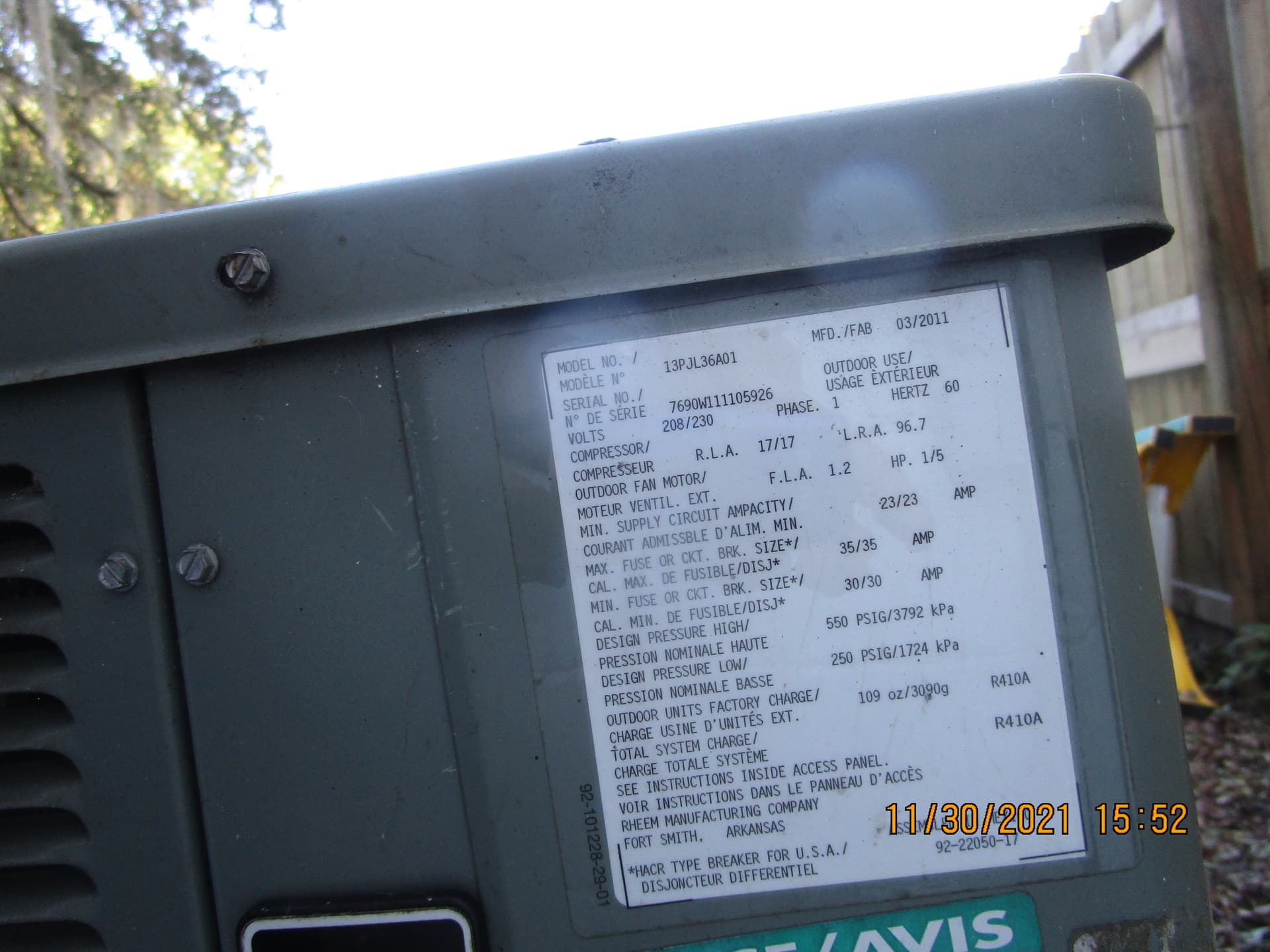

Heat Pump cooled well but barely heated

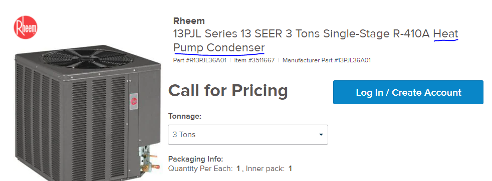

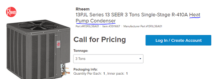

Would you mind sharing the model number?
it is a heat-pump that is not heating well. What was the exterior temp when you ran this in heat mode?
High 60s I guess.
Ok. Well I’m going to call it for what it is. Thanks for your help. I took plenty of pictures and have infrared data.
Yep agreed!
