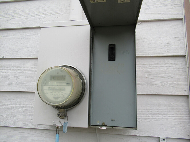

This one looks somewhat similar to what you have. The three SECs L1, L2, N come in from the top of the meter side of the enclosure. Turns into 4 wires due to the 2 Neutral bus bar holes on the breaker side of the enclosure.
I don’t see a service neutral at the main disconnect. I see the two ungrounded service conductors only. And the out the bottom we have the 4-wire feeders to the sub panel, and the GEC.
I assume the meter pan and the main disconnect panel are considered “bonded” since they appear to be attached together. Does that mean the service neutral could be bonded to the meter pan and that is good enough?
Look at what Yu posted above your post.
If you look at Yu’s illustration you see the neutral bus bar extends from the meter enclosure through to the disconnect box. It is essentially one box with two compartments and two covers.
Nice catch Simon. I’ll add that to the list of concerns.
Perfect. I guess that answers that! Can’t say I’ve seen that setup yet in my area.
