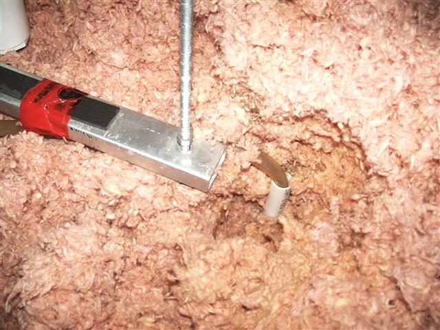

Here are some pics

Is there a drain pan ?
I see a condensation tube, but where does it go?

No drain pan, already called that out, thanks :slight_smile:
condensate line goes into a DWV.

Thanks Mark…but I was curious and wanted to view the exhaust/combustion air penetration area at the right side of the cabinet.
