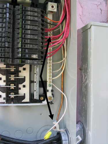

Harvey:
That bonding jumper is installed on a bonding type bushing because there are rings left in the concentric knockout, and if they were not present and that fitting took up the entire knockout, there would still have to be a bonding type locknut with a screw or wedge, but most likely a bonding type locknut, one with a "pointy screw" that would make a permanent and tight connection to the full metal enclosure.
Did you verify that the bonding jumper was sized properly?
Should be the same size as the grounding electrode conductor that goes to the water pipe and ground rod.
I hope that this will help to answer the question.
I would recommend reading the IAEI Soares Book on Grounding, and if anyone has that book there are lots of images that will make it easier to understand. Let me know which ones are of interest.

I see another thing that would concern me as an electrical inspector but is probably beyond the scope of an HI.
If he is using a metal raceway/nipple to the meter can I bet you $1 there is a parallel neutral situation. The power company grounded that neutral in the meter base, tied that to the can, which is in turn tied to the disconnect enclosure. That is path 1. Path 2 is the grounded conductor itself.
(personally I don’t see this as a baby killer but it does violate 250.6)
Standard practice is to use a PVC nipple to avoid this situation. The only other choice is to get the utility to unground the neutral in their meter base and that may not even be possible with equipment they buy. It really doesn't matter where the Ground electrode connects in this situation and a lot of utilities like it in their meter base
This is one reason a lot of places like the combined meter/disconnect box. Then your house is wired as a sub inside.

You said 250.6, Objectionable Current is the keyword of this section. Can you point me to the definition of Objectionable Current?
Personally I would say that any current flowing threw this nipple is objectionable but now we arrive at a problem, if you say that this is a violation of 250.6, so are many other things.
The GEC to a common underground water system.
GEC Taps as required / allowed by 250.64(D) & 250.30(A)(3)
A Common Grounding Electrode when required by 250.58
Here is a 400 amp service I installed with a PVC nipple at the meter, the inspector did not want to pass it unless I ran a separate bonding wire from meter to panel. I finally got him to change his mind when I asked if he would want the separate bond wire with an SE cable service.
Greg I would rather the inspectors here enforced as your area does, I just do not understand how they can pick and choose what is objectionable and what is not.
Point me to the definition of "neutral", what's your point?
I think it is generally assumed it is "objectionable" to have circuit current flowing in a raceway system.
The other examples you cited would involve current in the earth or piping on the line side of the service disconnect. (water pipes between homes etc) That is not NEC land it is NESC land. Earth return is really not that rare on the utility side.
