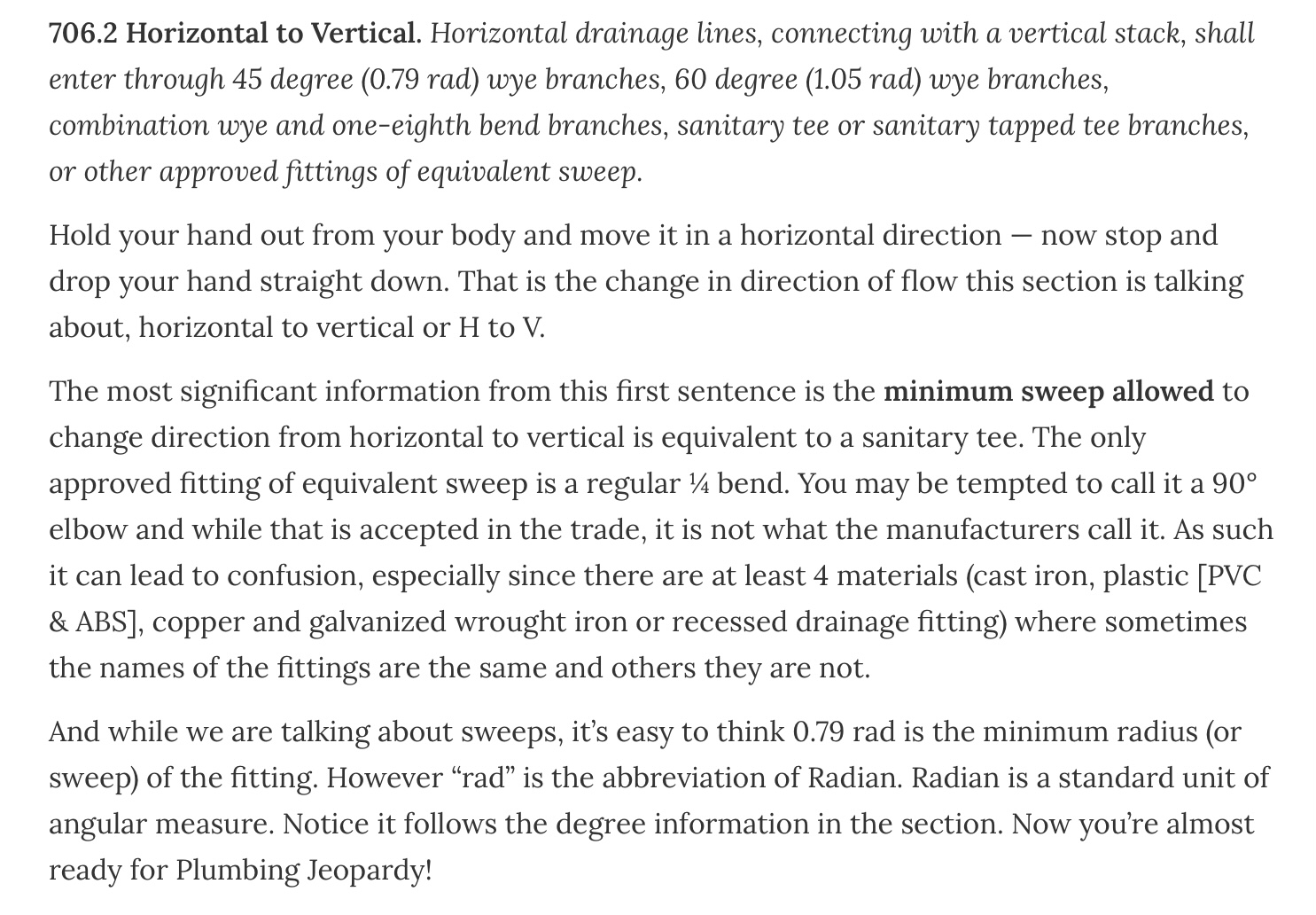

mcyr
(Marcel Cyr, CMI)
November 4, 2022, 7:34pm
849×1024 47.6 KB

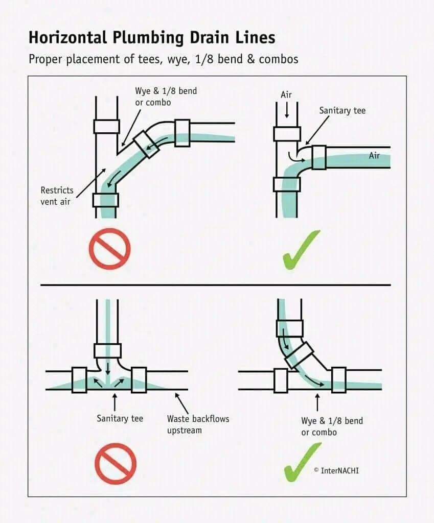

mwilles
(Martin Willes, CMI)
November 4, 2022, 9:56pm
2
1485×1032 377 KB
