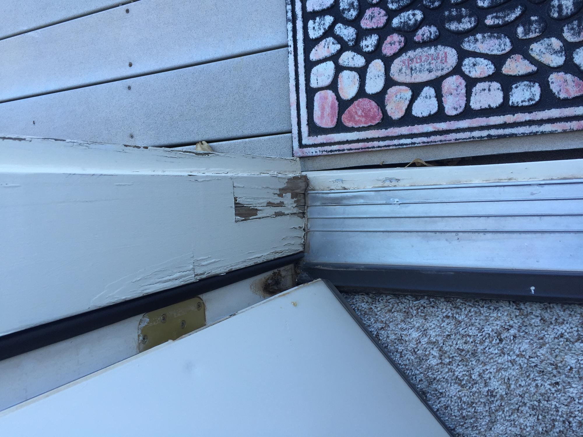

In this picture you will see some water damage to an exterior door jamb. This could have been just over the years that the paint/seal started to fail and or direct contact of high moisture. Nonetheless it was recommended that the home owner re-seal the problem area
