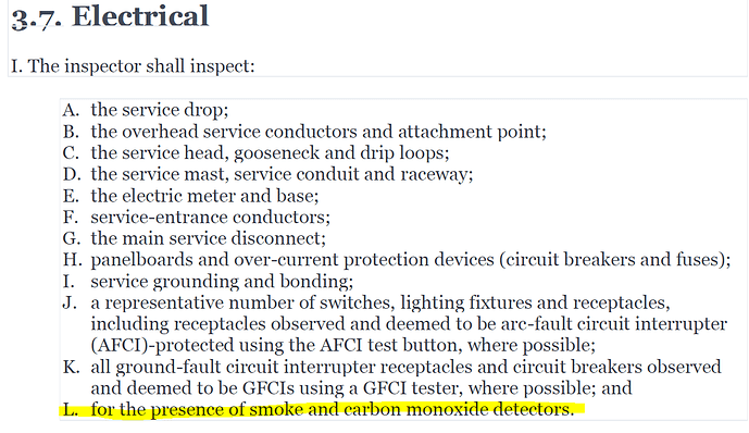

But a question for someone. If I was to do an inspection in line with Internachi SOP would this suffice
At the inspection it was determined that smoke, fire and/or carbon monoxide detectors were present.
In Indiana, SOP requires inspectors to report the absence of smoke alarms.
I don’t test them. I consider that a maintenance issue. I make a blanket recommendation to replace alarms older than 10 years and install and test per manufacture instructions.

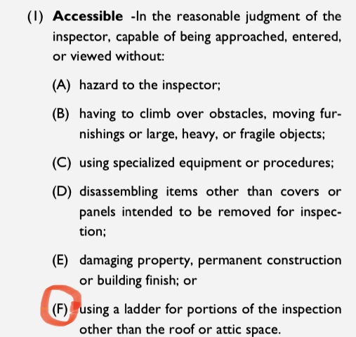

Texas SOP says you have to, unless you can’t reach them.
