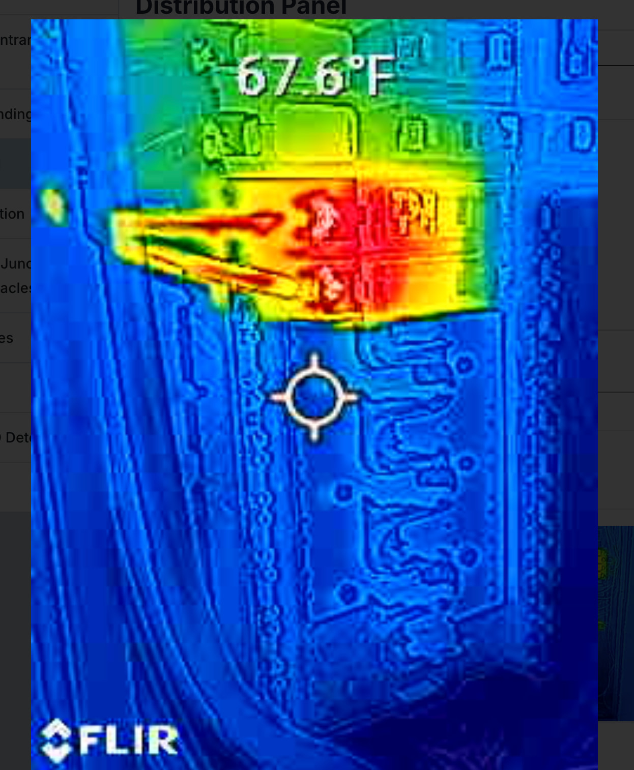

What’s your thoughts on this, @pabernathy? Ambient temp is around 70 degrees fahrenheit. Powering a Heat Pump air handler in the attic. Has been running for over an hour.
I’m not answering for him, but 112F is simply warm after running a load.
I see stacks of AFCI/GFCI breakers idling along doing that all day.
Example:
Not an issue! Leave the IR in the truck.
Better still, put on eBay!
I don’t like states telling home inspectors how to do their job, but if they truly want to protect the public, which is the ostensible reason for licensing, they should prohibit a home inspector from pointing an IR camera at electrical panels unless the inspector has had proper training and follows a well defined protocol. We both know that that’s never going to happen.
