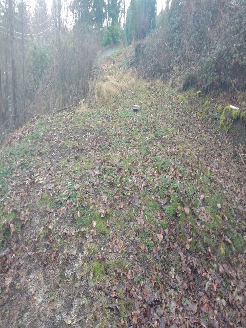

This pictures a rural septic system in southwest MN that was 4-5 years old. The sealed lids and electrical elements seemed in good order. The mound system was nestled between 2 sets of trees in the grove due to lack of space on the site.
