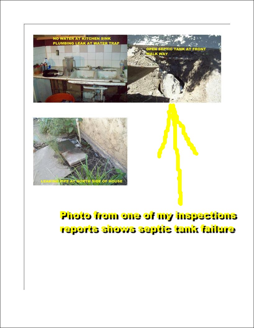

This is a picture of a failed septic system from one of my inspection reports. The septic tank is located at the front of the house. The first access hatch was excavated and opened. The hatch is next to the walk. A water supply line is next to the walk above the tank. The access hatch lid has been removed. Water in the tank is almost at the level of the access hatch. Drains in the house are backed up and no water can be used.
The exact cause of the problem could not be determined at the time of the inspection however the house is located in a large depression near where several feet of water form a lake at the South side of the house during heavy rain. There was evidence that the water had risen about a foot against the South wall of the house and the wall was sand bagged. The house is at the end of street that dead ends into the concrete wall of a free way about 20 feet above where water run off collects creating the lake at the South side during rain storms. The house is at the lowest elevation of the tract. Poor drainage at the septic system leach field here may have contributed to the septic system failure. The house was built some time in the 1970’s.
