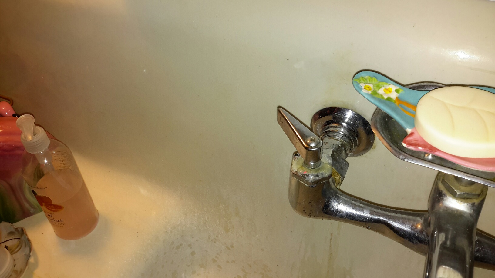

The image I choose is of an old leaky faucet. The client like the old fashion look. However after we calculated the water use could be an extra 150 gallons per day. Then when I explained what that means to the septic system ie ;the extra flow put stress on the absorptive capacity of soils; and may push solids out of the treatment tank and clog the lines or leach field.
I then suggested some new fixtures that look old and cost much less than a new septic system.

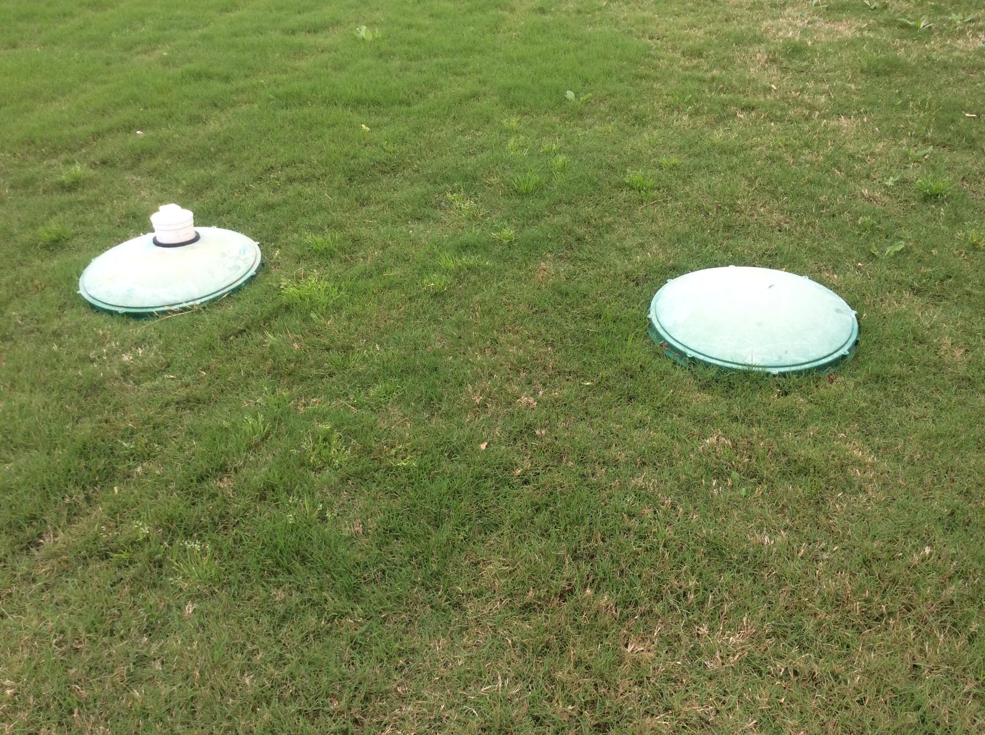

Access lids to system located behind garage. Access port is in poor condition and screws are striped in lid. Lids should be secured to prevent potential safety hazard.

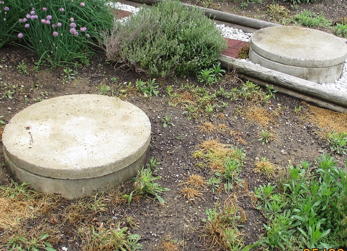

This septic tank was installed to close to the home. The tank is only 8ft from the home and directly under a bedroom window and 5ft from the patio. After removing the concrete lid to gain access, the access ports were sealed with bee’s wax to stop the smell from the tank to the bedroom.

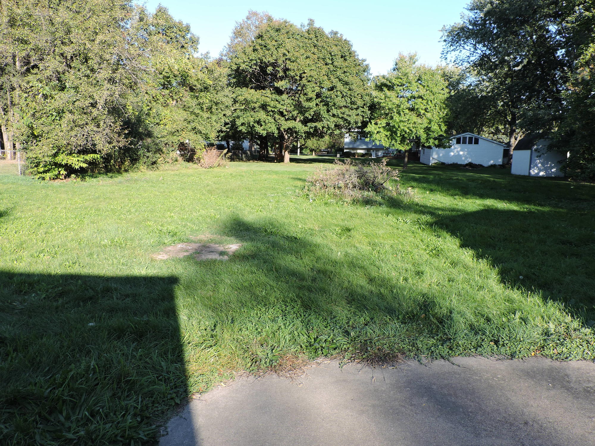

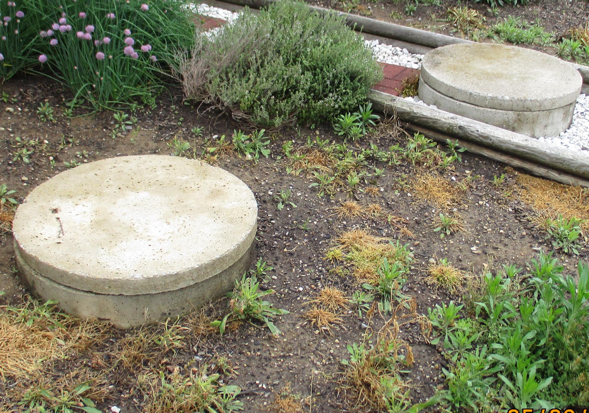

I have just found the septic tank lid and vent. I will now be able to evaluate the situation and determine what condition the septic system is in. Thanks to the training I feel confident that I will be able to locate any problems and find more tamks and fields in the future.

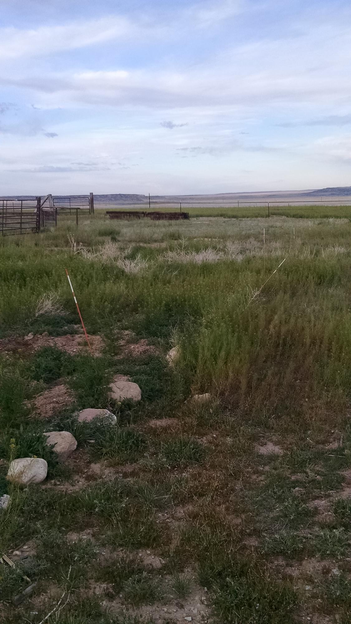

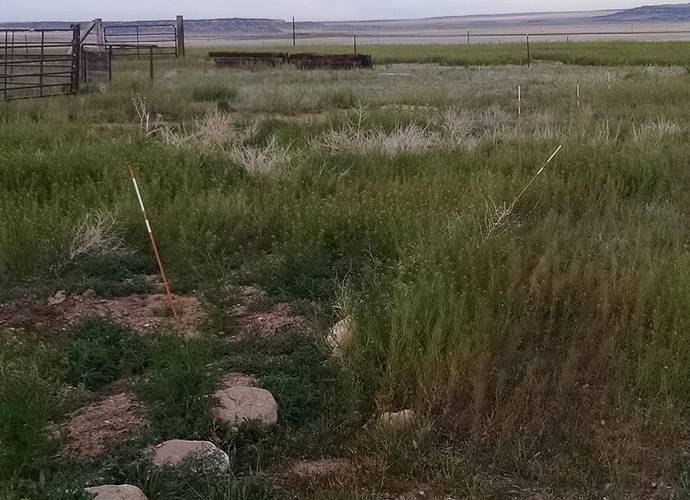

This is a picture of my own absorption field. Notice that we have placed markers around it to direct traffic flow off the field. We did this to keep the propane truck, livestock trailers, and other heavy equipment from driving on top of the absorption field. This should help the life and flow of the septic system.

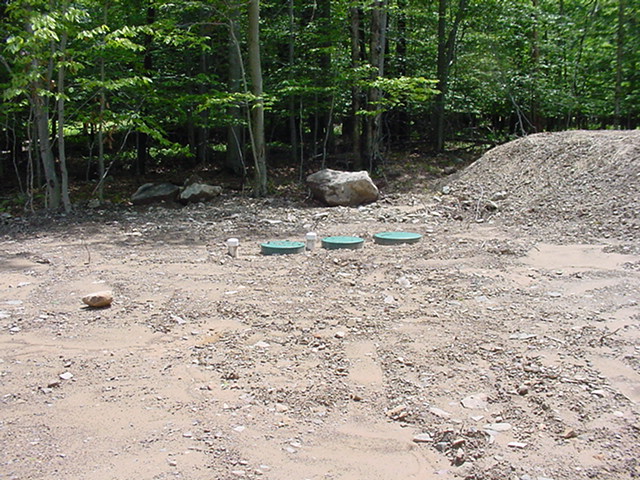

This photo illustrates a newly installed three compartment combination septic and dosing tank. The first four inch pvc pipe starting on the left is the access for the inlet baffle observation port. This is where the raw sewage from the residence enters the Tank. The green large lid next is the main access to the primary compartment of the septic tank. The third pipe, pvc, is an observation port to the secondary baffle. The next green lid is a main access to the secondary treatment tank. The third green lid is the access the dosing tank, pump and switches. To the right of that is the elevated sand mound, or absorption area, to which the effluent is pumped. The condition of this system is new and not yet in use.fontanez 004.jpg

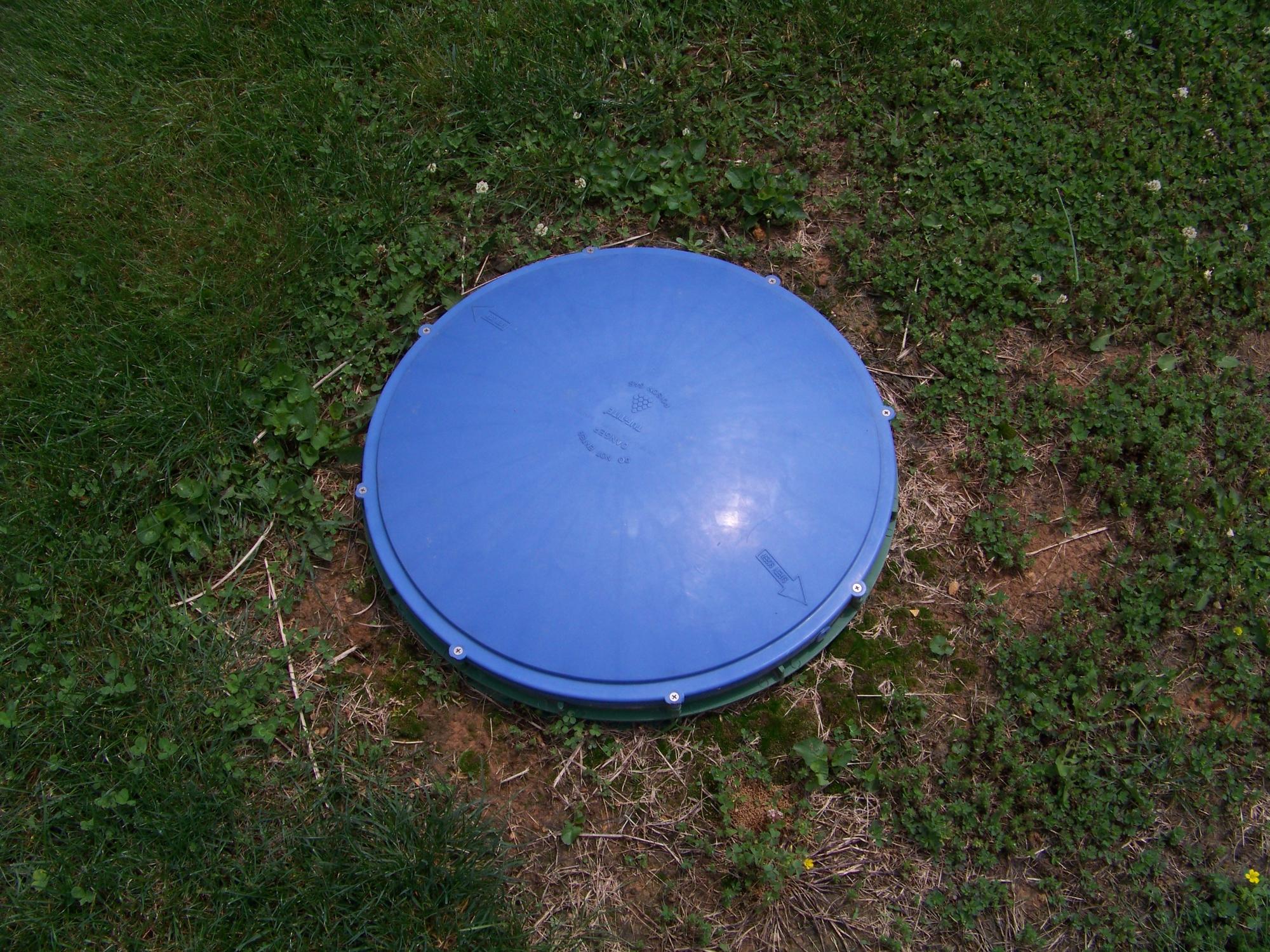

The house that is being inspected did not include a septic inspection. However, the septic tank cover was indentified for the buyer. The plumbing drains were inspected and work satisfactorily.

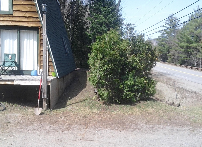

The attached photo depicts an existing onsite wastewater adsorption area as my component for review and discussion. Based on records research and confirmed by site conditions, the entire septic system was installed over 30 years ago and does not appear any alterations have occurred. The adsorption area (locally referred to as a leach field), is located on a narrow strip of land between the residence and the roadside ditch. Of concern for the proper operation of the component are the close proximity of the hedgerow, and thus the roots of the hedges to the system component, and also the roof casting rainfall runoff down onto the component. It would be a proper recommendation to note removal of the hedges to prevent root intrusion into the component which could result in a reduction of dispersal of effluent into the soil, and diversion of the roof runoff through a gutter system.

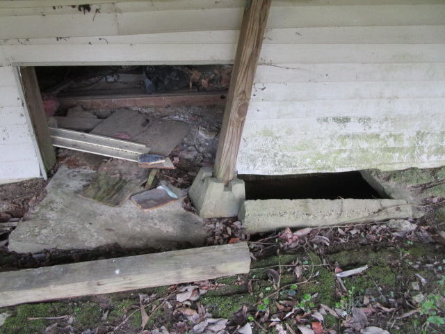

This septic tank had a damaged lid and the deck and addition had been built over top off the tank. Notice how one of the deck support posts was sitting on the damaged tank. Never know what you will find at an inspection!
