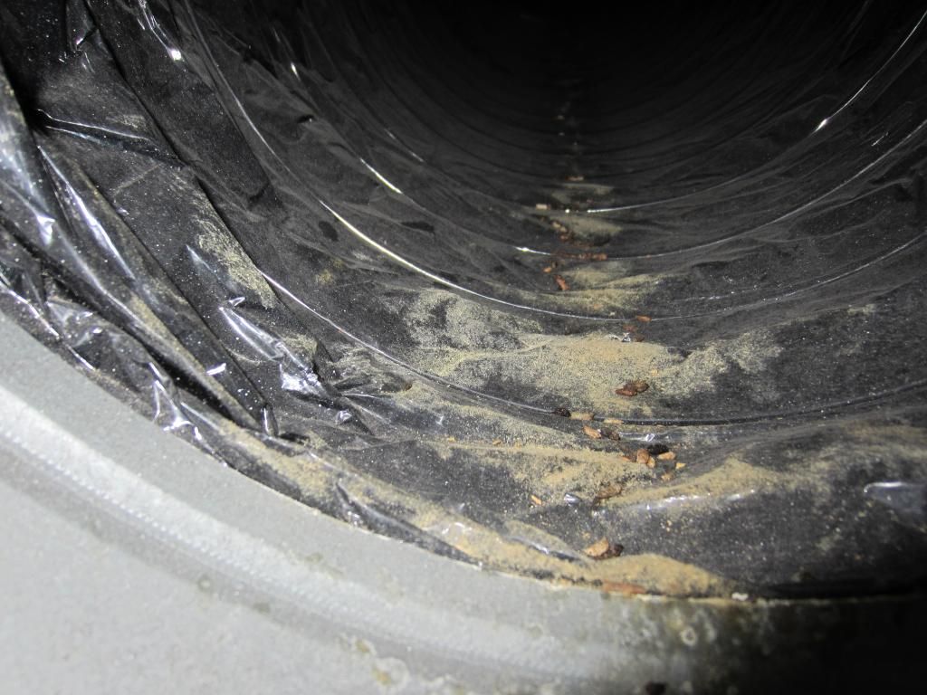

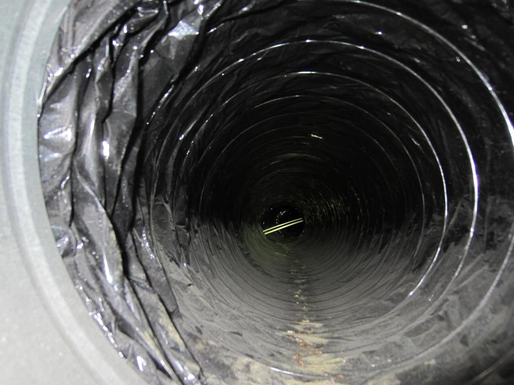

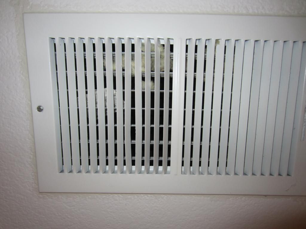

Recently came across a living room ceiling duct with what appeared to be insulation resting on the louvers of the register. I removed the register to find rodent droppings and an electrical sheathed cable running through the interior of the flexible duct. I assume this happened when the recessed lights were installed. Saving a few dollars on drywall repair but opened themselves up to rodents and duct leaks. Major fail!
