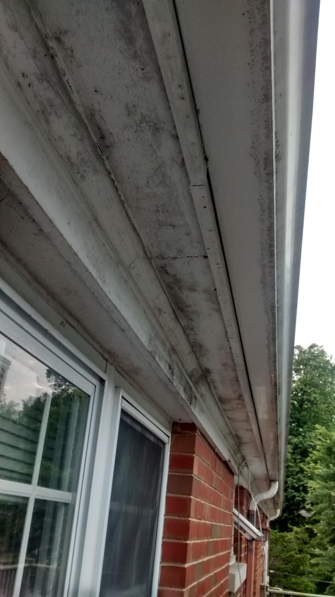

On my Friend house I found no soffit vents with heavy mold build up (on North side). Soffit on South side however, looks good. I asked owner to let me in to the attic…See following pictures.
Part of the roof (above the window) was insulated by owner just 6 months ago: no soffit vents, no attic Ventilation Channels (providing air flow) along with wrong type of insulation…
