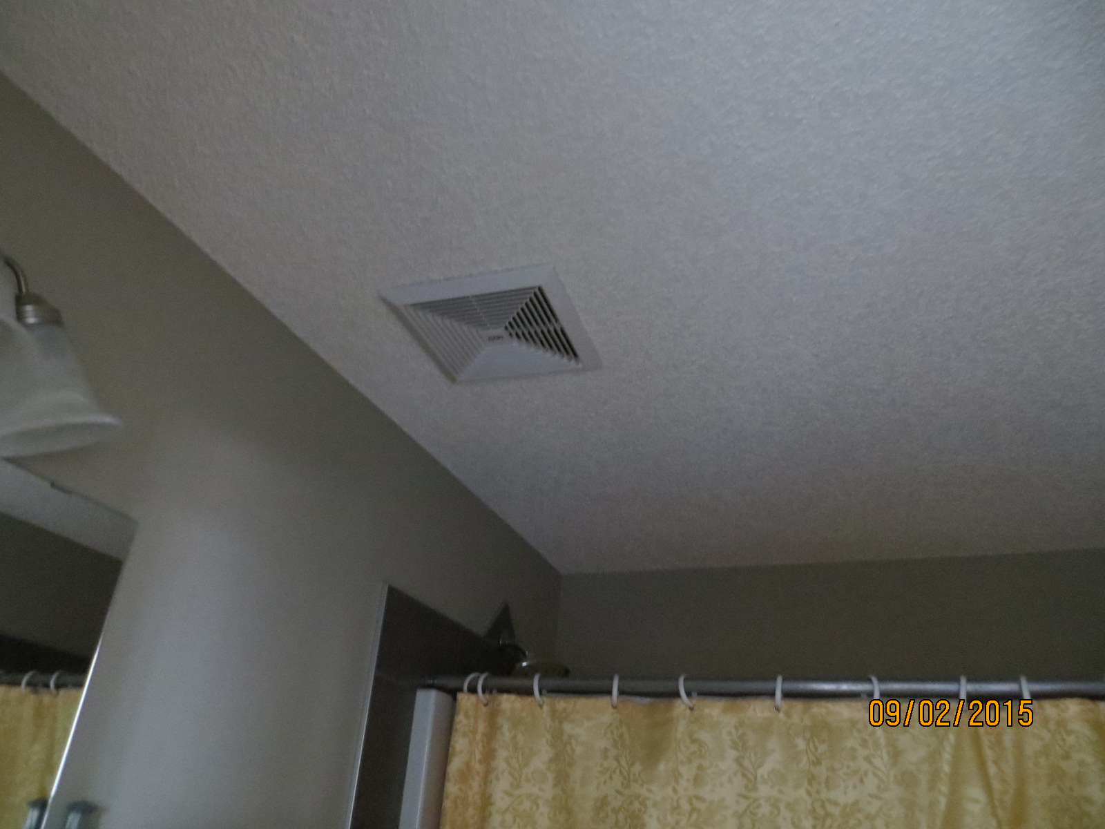

This a bathroom vent that exits inside the attic. This vent should be run to the outside of the home. This vent was referred to a qualified contractor.

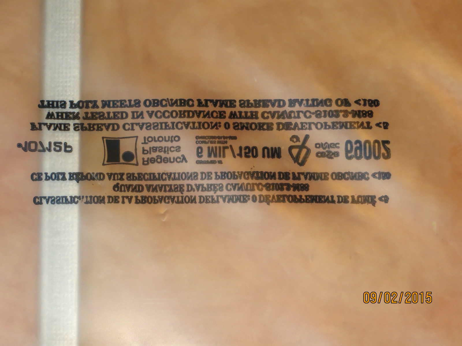

Basement Wall PE Vapour Retarder/ Insulation
Basement Tar Coating
The Builder put the insulation ,PE and tar coating …adding the Dry Wall is a
must !!

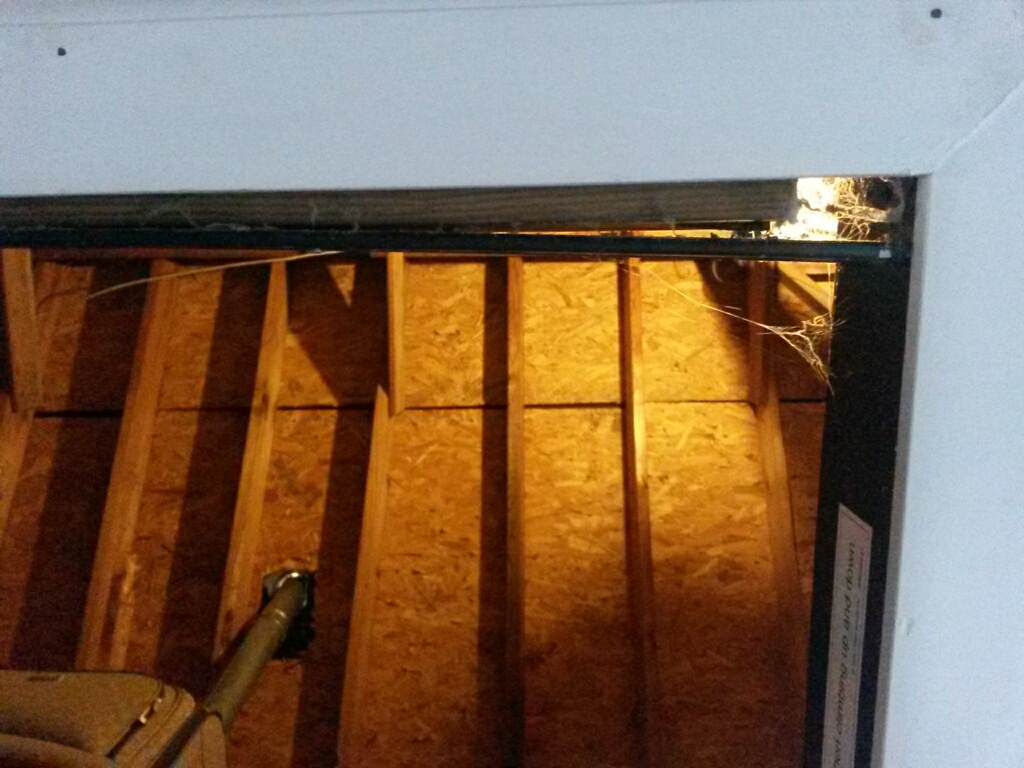

I inspected the attic access panel at the home on 148 E. Floyd.
The panel door is made of Plywood (1/2" ) and is baccked with glued on R-19. However there is a large gap which is causing hot leakage into the habitable space below. It should be sealed.
