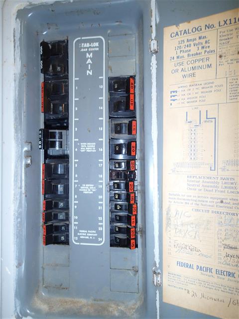

The main panel was located in the garage, it does not have proper clearance, it should have and area 30" wide and 36" deep for access during a emergency situation.
There was also areas of concern noted in the pictures one connection appeared to have been hot and scorched at some point and another appeared to have been hot and bubble the wire insulation.
Note as well that this a Federal Pacific Panel and breakers provided in this home there is a documented history of failures with these devices which presents a adverse condition for the home and it’s occupants.
This along with the other issues presented in the pictures recommended it should be further evaluated by a qualified electrical contractor.

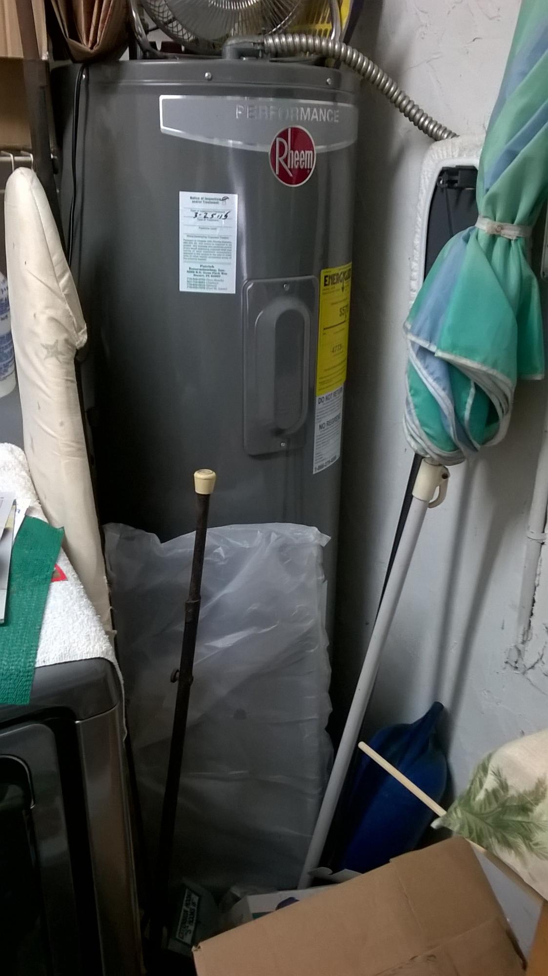

After reading the article about electrical safety, I decided to look around my own house one more time.
As you can see, around and on top of the water heater is packed with junk. This is not safe at all. If the water heater was to has problem, I would be tripping over everything to get to it, and possible getting shocked trying to get to it.
Noted where the Main Panel Is.
I can thank My loving wife for being a Hoarder.

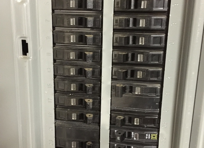

This panel is a subpanel located in the basement/garage area. It is fed from the main house panel located upstairs approximately 8 feet away. There are several items of concern with this panel that should be further investigated by a qualified electrician as follows :
  1. Feed from upstairs main panel is via a parallel pair of AWG#10 wires allowing 60 amp capacity total. The main panel breaker feeding this is rated 50 amps. Effectively this subpanel is only capable of supporting a 50 amp maximum capacity.
  2. The parallel AWG#10 conductors are double-tapped to the subpanel 100 amp breaker. Double tapped connections should be corrected and the 100 amp breaker either removed or replaced with a 50 amp breaker to reflect the true subpanel capacity.
  3. There is a 2-pole 40 amp breaker in this subpanel which further feeds another subpanel located in the far side of the garage. This breaker should be a GFI breaker - it is not. This can pose safety hazard issue in the garage or the add-on subpanel being fed by this breaker. It is noted the AWG#8 wire used for this 40-amp breaker is suitable for up to 50 amp capacity.
  4. There are nicks on insulation of several neutral wires and several hot conductor wires are not fully seated into their breaker connection points.
  5. Two of the circuit breakers do not appear fully or correctly seated onto the subpanel bus bars. These should be checked and seated correctly.
  6. A surge protective device is installed in one of the breaker positions. There does not appear to be any means to test if this surge protective device is working correctly or note. The lamp on it is the only indicator present.

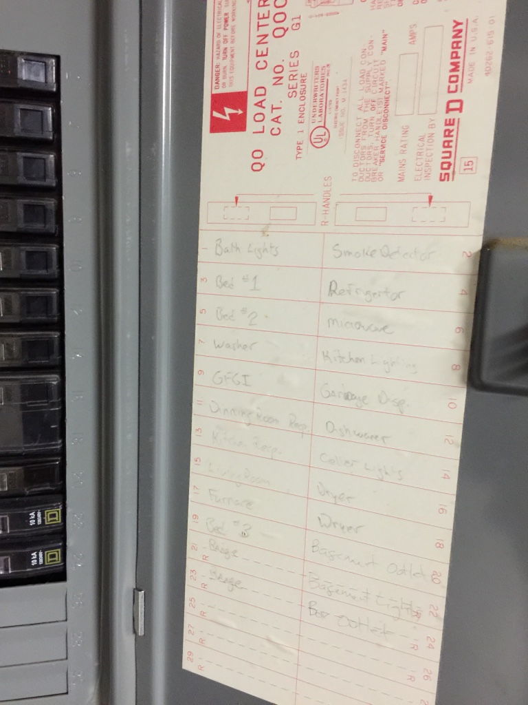

As you can see in the photo all breakers are labeled and the double pole breakers are isolated with a split-bus. This fuse box it correct with no arcing and no signs of water damage that needs to be referred to a specialist.

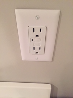

I inspected the outlets in a bathroom. They were protected by GFCI outlets. The cover plates had all screws, the covers were secure, and the outlet was also secure. I checked to makes sure that the GFCI tripped and reset properly. I checked each outlet to have the correct polarity and they did.

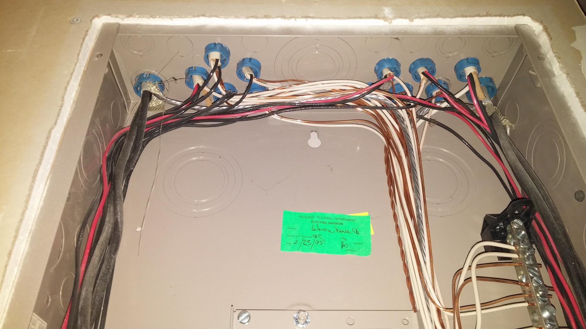

The electrical panel is a 200 amp Cutler-Hammer unit located in the attached garage on the east wall. The wiring appears in order and functioning properly. There are bushings present in the conduits which the wires are routed. The breakers are labeled on the door off the electrical panel.
Electrical panel with a 200amp service located at exterior rear of home
There was a proper ground source installed
Service drop was serviceable

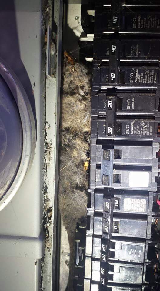

A dead/electrocuted rat was stuck along the breaker sides appearing to enter from the crawlspace through openings at back of panel.
Openings found
Recommendations:
Recommend further evaluation, removal of rat/debris and all necessary repairs by a qualified electrical contractor to eliminate any future intrusions

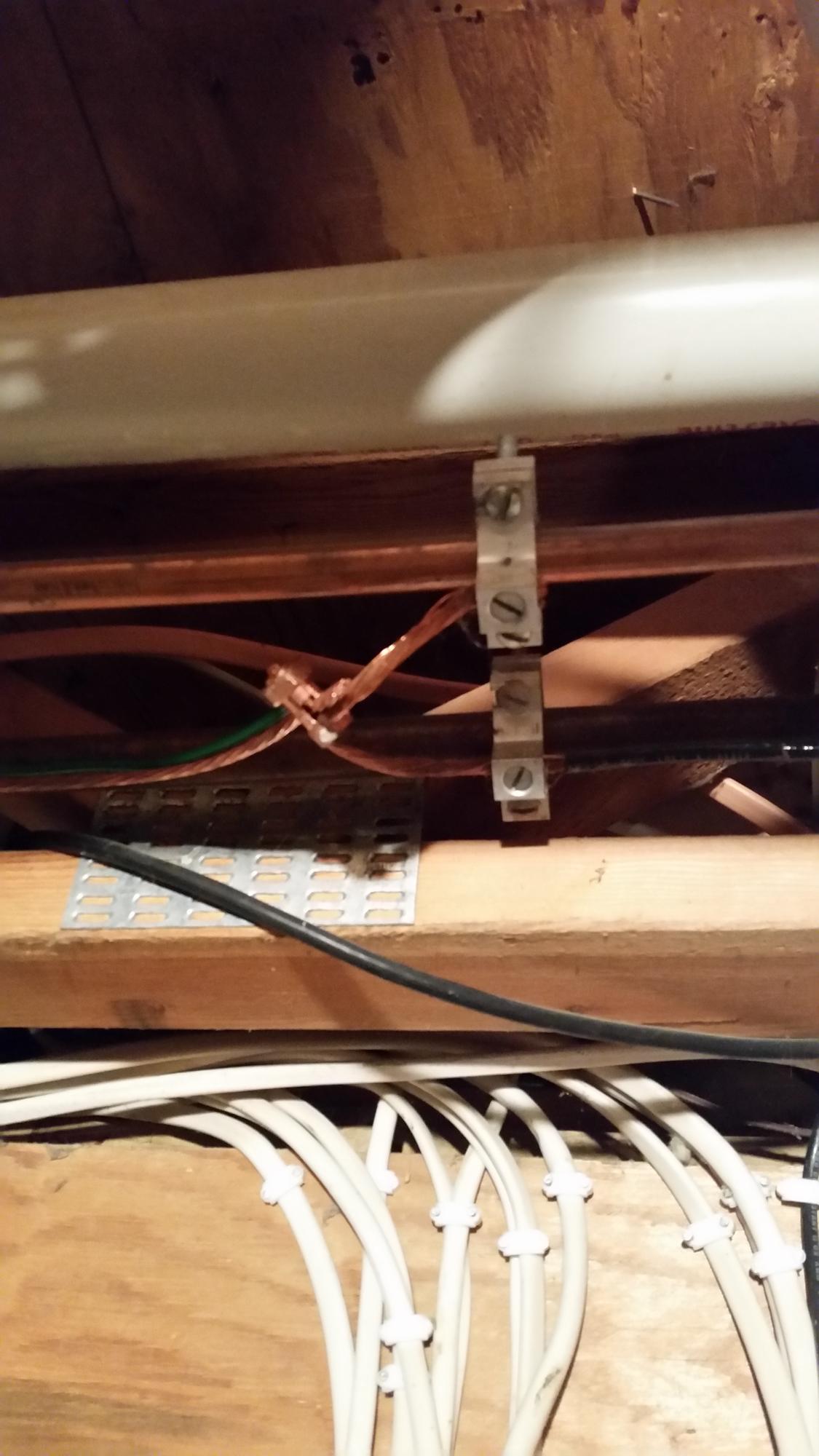

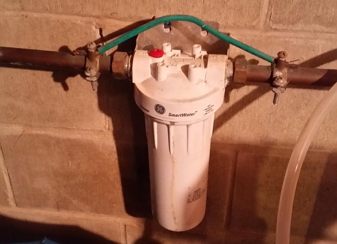

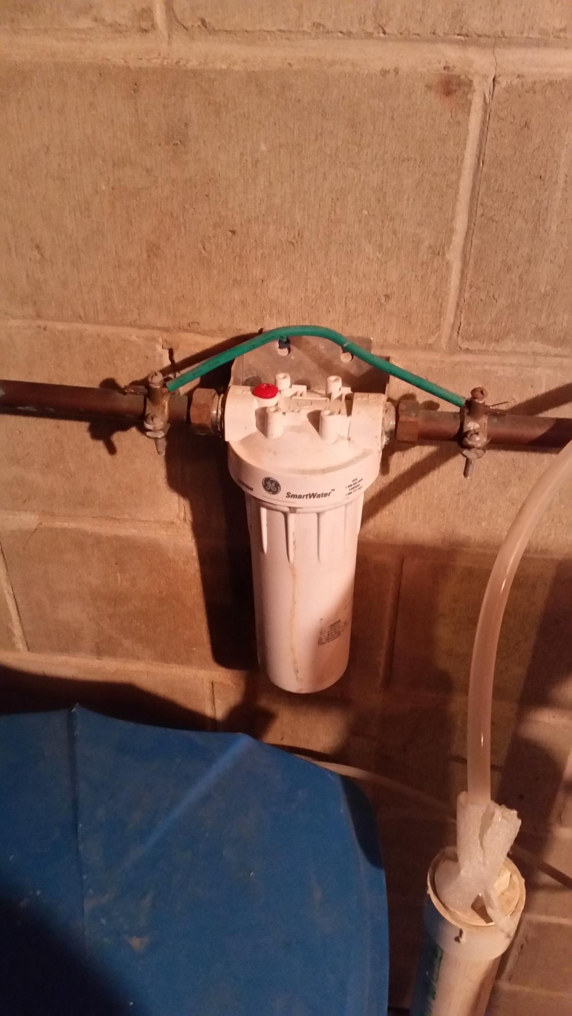

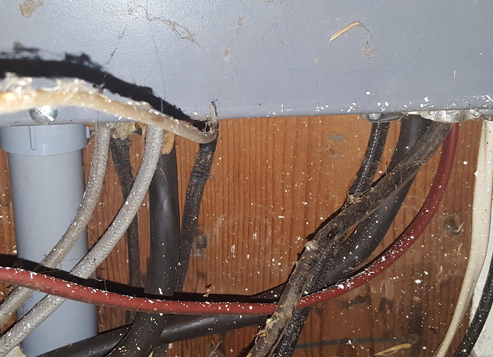

I inspected the electrical panel and it looked good, so I traced the ground connections. The first picture is of the connections to the copper water pipes I found. This looked good and used #6 copper for the 150 amp panel. I then made sure the water pipes had the proper jumpers, which I show in the second picture. I then traced the green ground wire to see where the second source of grounding was at, but found that it went out of the house to be left dangling where an old satellite dish was hung. There was no second source of ground. I would recommend attaching the loose ground wire at the house exterior to an 8 foot grounding rod.
