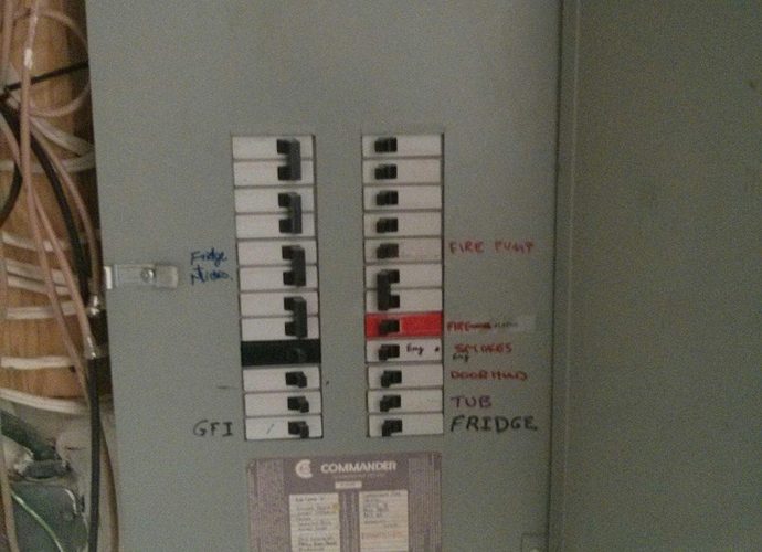

This breaker panel has a table indicating what each breaker services.
It also has handwritten notes beside some of the breakers.
Some of them don’t match so its true purpose is not known.
Breakers are to be clearly marked as to their purpose without contradicting notes.

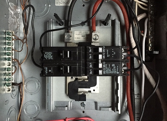

inspection of electrical service panel in the garage which is fed from a 50amp breaker on the main distribution panel in the house, this breaker was tested and when turned off it disconnects power to the garage. the garage is serviced by a cutler hammer panel rated at 125amps.
the dead front was removed to facilitate the visual inspection of the wiring in the distribution panel.
this panel is serviced by 2 phase 240volts with #6 copper wires, the black and red wires are hot and the blue wire has white electrical tape on it indicating it is the neutral. the blue wire is connected on the ground bus bar.
there is aluminum tape covering a missing plug on the left side of the panel. although it is covered, it isn’t using a proper plug cover and will be noted.
top left breaker, rated 20amps, feeding 12/2 copper wire to wall plugs
bottom left breaker, rated 20amps, feeding 12/2 copper wire to wall plugs
top right breaker, rated 15amps, feeding 14/2 copper wire runs the ceiling lights
note: right breakers at center are bridged and designed to run 240volt devices such as a heater. only one phase is being used at 20amp to the 10/3 copper wire coming from the bottom of the panel. the red wire has not been used and is not connected to the panel. this 20amp 120v circuit is being used on a single outlet for a 120v welder which is rated at 20amps.
bottom right breaker, rated 15amps, feeding 14/2 copper wire runs two ceiling outlets and the garage door opener.
note also: the incoming power wires have scratched casings from being pulled into the box. close visual inspection with a flashlight did not reveal deep cuts and are probably only cosmetic defects. to confirm this and the aluminum tape, an inspection by a qualified electrician would be advisable.

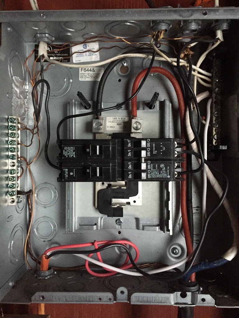

in the attached photo, this service panel has two defects to note. all wiring is copper, aluminum wiring concerns will not be an issue in this wiring scenario
  1. on the left side of the panel is a missing knockout, this could allow moisture or other intrusions into the box
  2. on the right breaker there is a double-tapped lug which is considered a defect. left uncorrected there is a potential risk of fire
a qualified electrician should correct these deficiencies

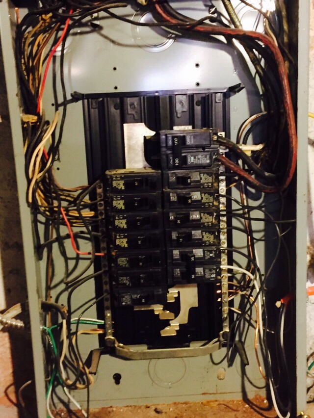

This is an image of an older Square D 100 amp distribution panel that has been refurbished and repurposed to use indoors in a storage room.The panel has several reportable defects. The first being that as soon as you open the hinged door you notice that all twelve spaces were used at one time, whereas now, only four are used. There should be blank covers over the unused holes to prevent accidental shock or electrocution.The second is the dead front was installed using four socket head sheet metal screws. This is a major defect as the pointed tip of the screws could pierce the insulation of the ungrounded conductors causing an arching event or electrocution. Blunt tipped universal dead front cover screws should always be used. The third defect is that the manufactures label is missing from inside the cabinet. There are still several small certification labels attached, but the major label listing the panels capacity, approved aplications, approved breakers, ul listing, patent numbers and all the other really important stuff way to lengthy to list here. Recommended immediate replacement by a qualified professional electrician.

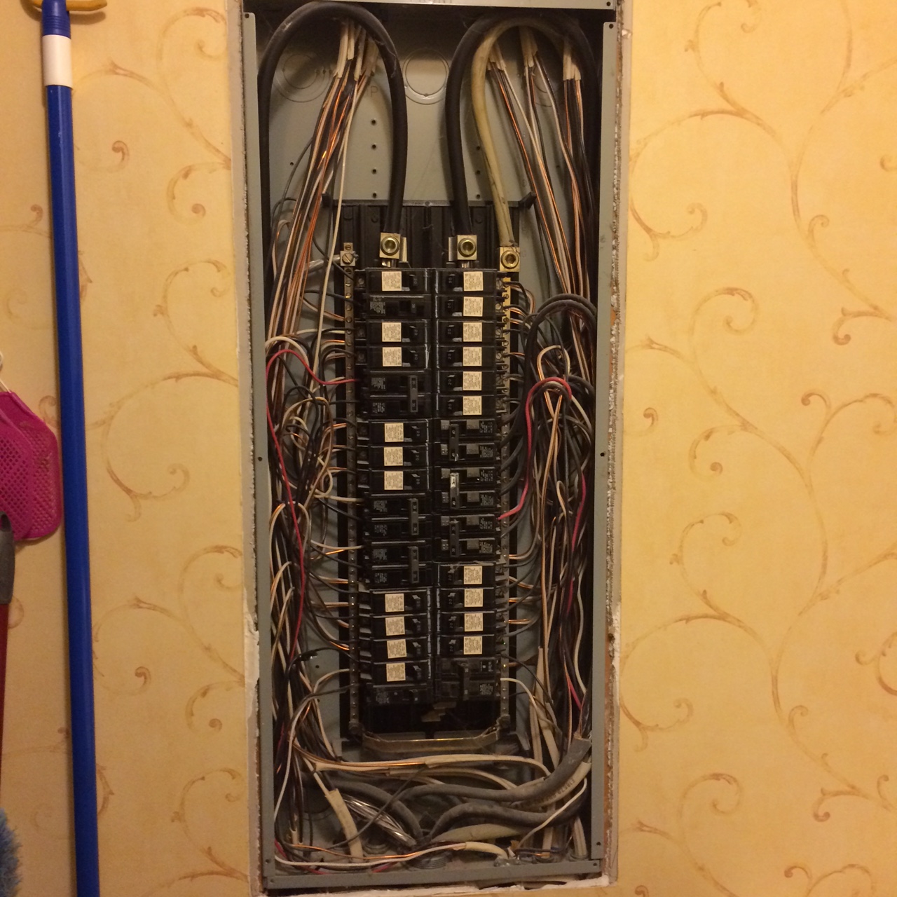

This is an image of a a square D panel with all square D breakers, except for #31. Upon inspection of the main service panel, my initial observations is that there is lawn equipment leaning against the service panel. The top of the service panel panel is missing the screws for the dead front on both the left and the right sides at top of dead front. The service panel is labeled well for all breakers; however, there is no main disconnect and is unable to be disconnected with 6 hand movements. After investigating, there is no other main disconnect upstream of the panel. I would recommend that a qualified electrician install a main service disconnect and at that time check #31 breaker to ensure that it is a correct square D breaker as there is no labeling on breaker. I would also recommend installation of the correct screws on dead front.

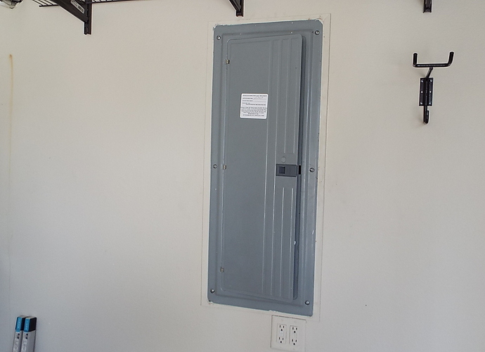

The 200 amp Siemens panel was located in the garage. I removed the dead front cover and found no discrepancies. The copper branched wires and breakers were very clean with no signs of previous arching or over heating. The clean copper wiring also indicated even the though the house was built in 2004, hey day for Chinese drywall, this panel did not show any visual blackened discoloration of the copper wiring.
