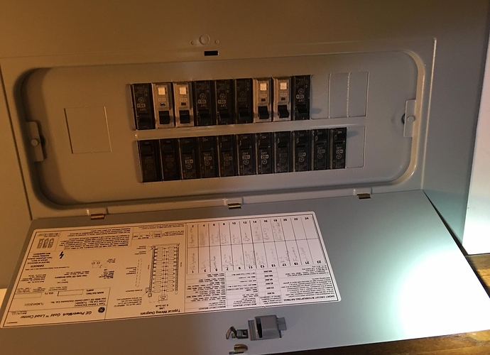

The attached photo is of the Electrical Distribution Panel within my home. The Panel is located in my garage and fully enclosed within a Semens electrical box. The panel appears to be free of defects. The legend is fully filled out and legible. Notice the 50 amp breakers (120V each) supplying the stove are connected on a 240V circuit. Both 120V conductors are tied together by a handle tie to ensure if one of the circuit trip due to over-current conditions, both conductors are turned off for safety reasons. Also note in the picture a GFCI within the garage. If properly installed, all electrical outlets in the garage downstream of this GFCI outlet should be protected which meets NEC requirements.

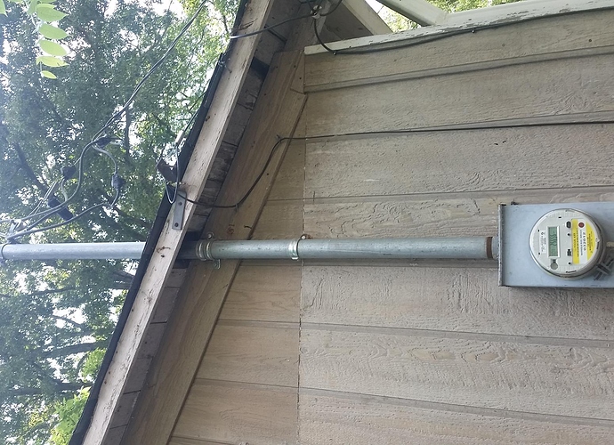

These overhead service entrance conductors don’t have a loop to prevent water from going into the gooseneck. The points of connection are improperly insulated. The service mast is not clamped to the structure within 12 inches of the meter box.

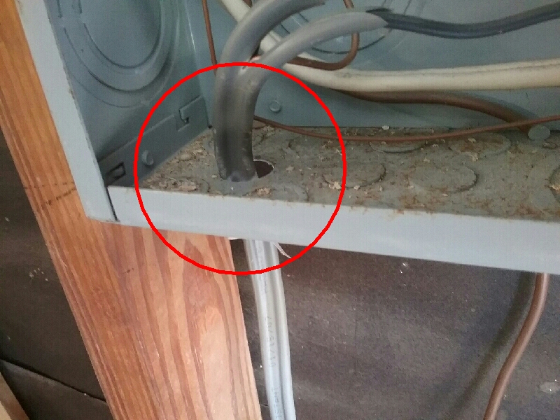

This Home I inspected a few weeks ago had a sprinkler system installed as well as a dedicated circuit for the controls. The circuit was installed in the garage where a GFCI was required and not present as well as there was no clamp to secure the wire at the panel or the outlet box. In this photo you can see where the wire has started to show signs of damage even though it has not cut through to the conductors. I recommended that a qualified licensed electrician review and repair/replace as needed prior to the end of the option period.

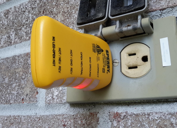

Here is a little essay on a tool used for How to perform residential electrical inspections course. I have had a GFCI receptacle tripping every now and then. I bought a GFCI receptacle tester and decided to see what might be wrong. I plugged the tester into the outlet I thought was suspect and sure enough it lit up red and told me there was a bad ground. Power off I Pulled the receptacle and tightened the ground, Retested and got the green light. As an inspector we will not go any further than the test of the GFCI , but if we find one receptacle with a problem there will most likely be others on that same branch circuit with a problem down stream of the GFCI. Recommend an Electrical Contractor fix the issue.

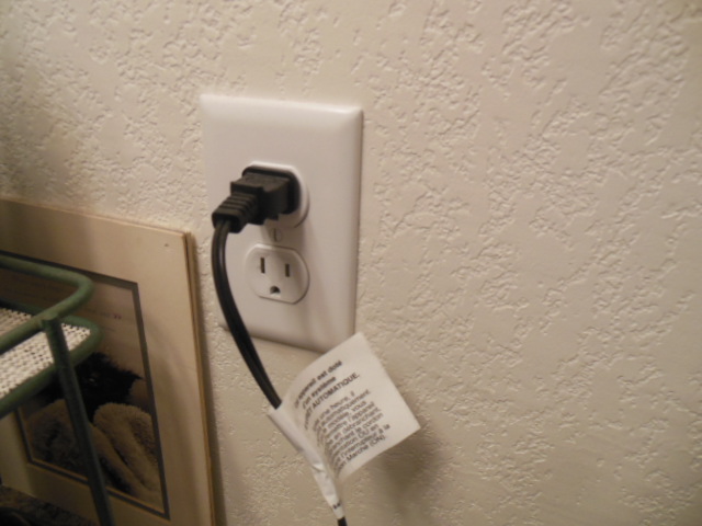

Just finished taking the course. The pictures that I have posted are in my home. In two of the bath rooms we do not have GFCI outlets and they are by the sinks with water. I checked the panel and found I have one breaker that is for the outlets. It is not a GFIC breaker either. Not sure how this was not caught by the builder. I will have them on the phone Monday to see what they want to do about this issue. Other than that bundle I see no other issues. On the panel picture the breaker for the bathroom is on the left bottom. Just a standard breaker???
